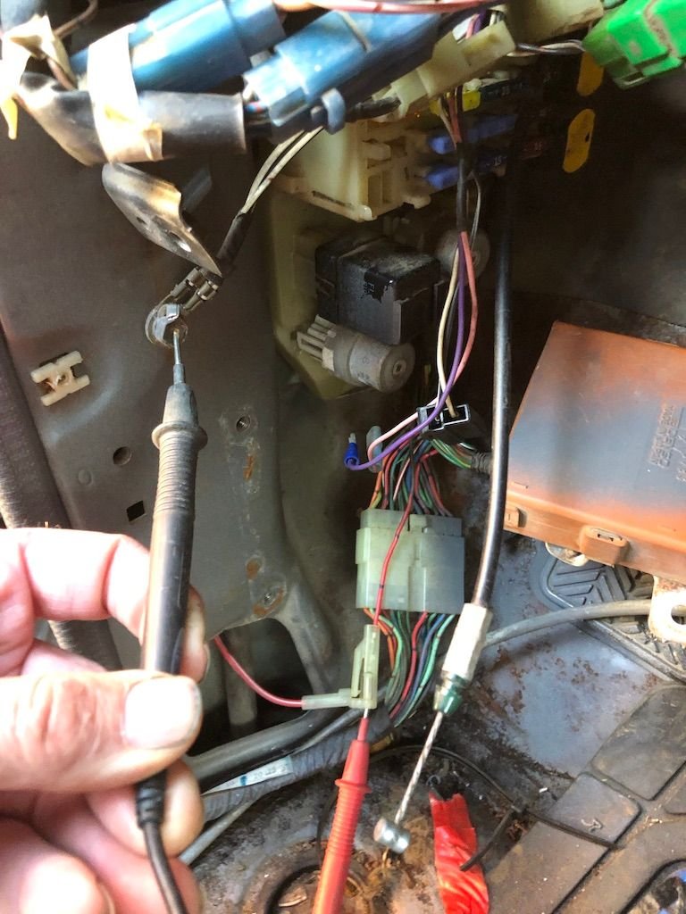

I have voltage at the connection of the door courtesy switch on the driver side door. I have read most of the build ups and searched the tech sections with no luck in finding any information.
all the research i have done shows that there should not be a voltage reading on the ground wire end of the circuit. the wiring diagram shows a diode on the circuit but i can't find where it is located.
I have pulled the dash and traced the wire to the passenger light controls box but according to the wire diagrams, that circuit is a different breaker.
Does anyone have any suggestions on where to look to fix this.
I should also say I am not a mechanic, I haven't worked on cars since this rig was new, my girlfriend picked this one up several years ago but has to pull battery cable every time it isn't running.

Do your dome / courtesy lights work?
I am trying to picture exactly what you are measuring with your multimeter.
Can you tell us exactly where you are putting your red and black probes? A picture could help too.
Is any part of the dome / courtesy light circuit disconnected?
When devices are ground-side switched, like the dome lights, and the switch is in the open position (turned off), you will have battery voltage all the way up to the side of the switch that is connected to the lights.

yes i can turn the dome light and map lights on with the switch on the light, it does not come on when i turn it to door. I had to replace some wire in the roof under the headliner to make that work. the only thing that is not connected is the door switch on the driver door. when i connect it the fuse blows. I did take the passenger switch wire off and checked it, it did have voltage and when i reconected it the light comes back on.
