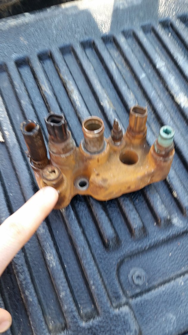

Can anyone tell me what sensor this is? It's on a 94 3.0 runner. It was broken when I saw it and can't figure out what it is. It's the one my finger is pointing to in the pic.

Thermal Vacuum Valve (sometimes Bi-Metallic Switching Valve)
Connects evap canister to throttle body for vacuum; shuts off vacuum when engine is cold.
