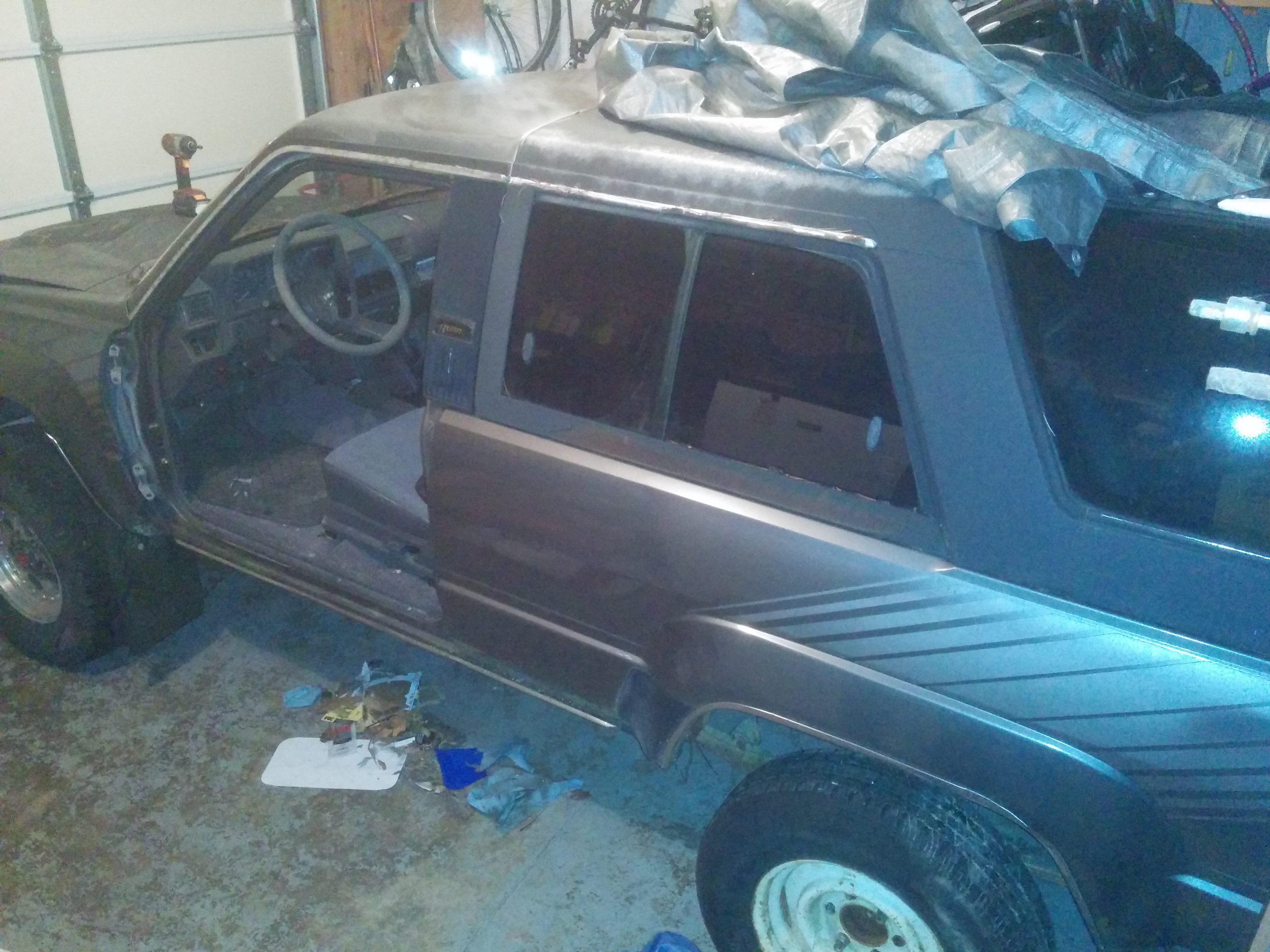

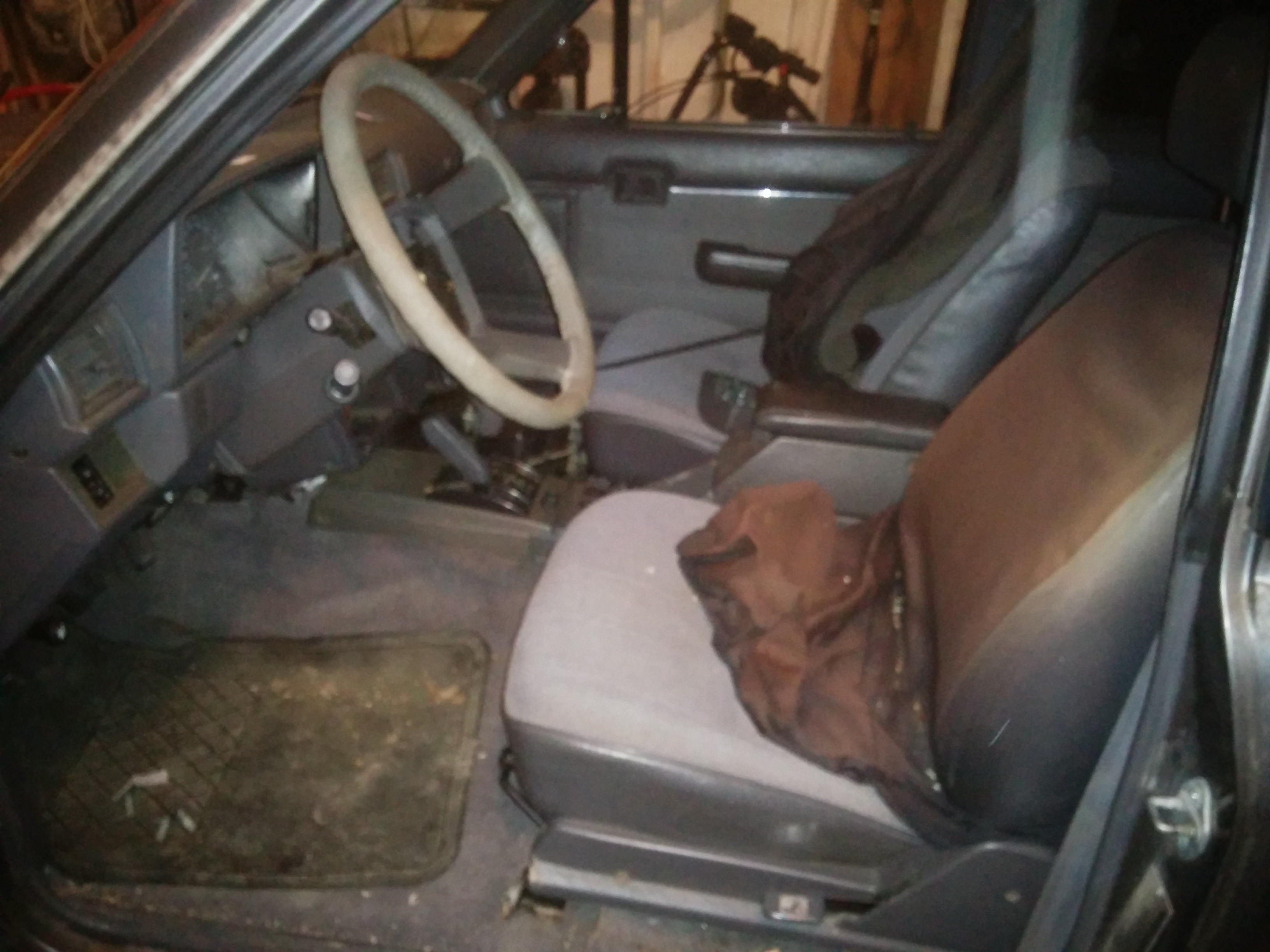

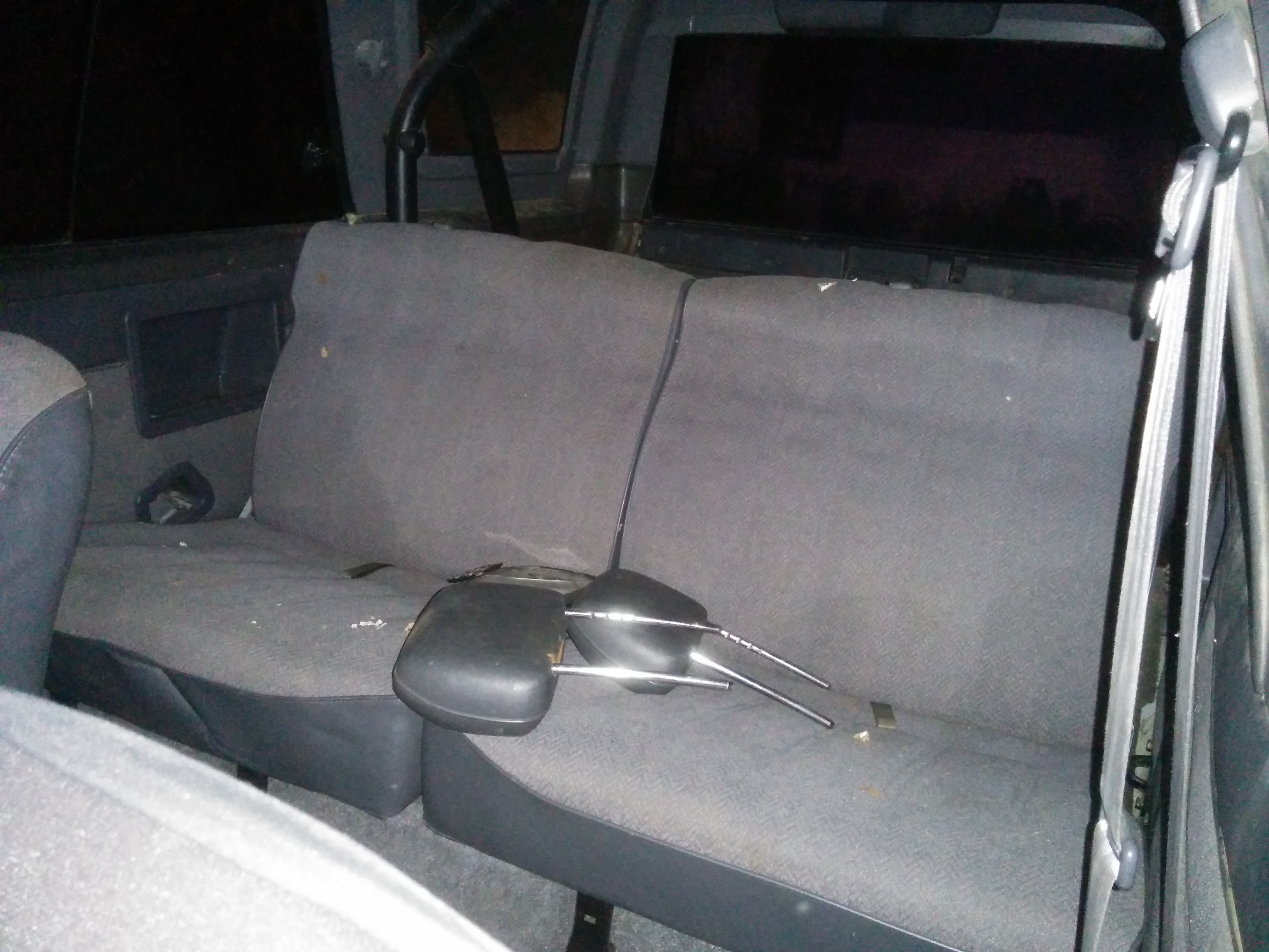

I dont think i would need to remove all in cab wiring harness considering they were manufactured in the same year '88 as well as both being EFI already. I finally found some swaps and they said the same thing, easiest way to do it is to remove both dashes' and swap, which is probably what ill end up doing.
The door on the silver one was put on my red one tonight for the mean time.

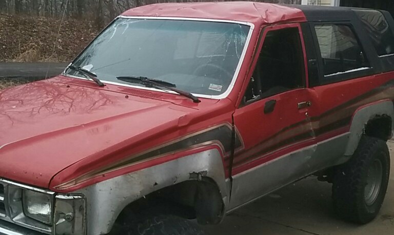

How bad was your original rig wrecked?
If the frame is OK might be easier to swap the cab & Box?
(Assuming it's a 4Runner)
Wreck was not that bad just cant put glass back in from the crinkled roof, pics are a couple posts up (The red one) as far as swapping bodies i thought about it but its just as much work if not more since the harness's still need to be swapped.
