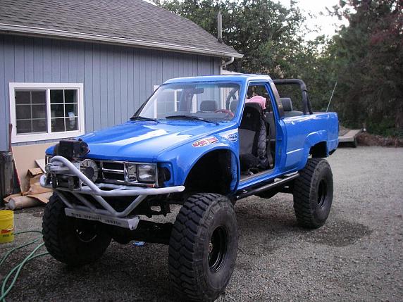

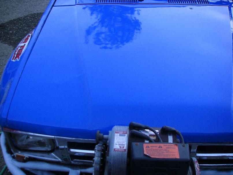

Just did the yoda Sail Blue- strictly wheeler didnt do any body work- its lucky it got paint at all lol.
Stay away from laquers (Dupli color paint shop) Rustolium enamel would be a better choice...really. If your going to spend anything stick with a single stage enamel, simple and forgiving. PPG concept is a good quality value line. the only thing I have seen to add to what everyone has had to say is after color sanding, hit the paint with a good finesse with a quality bonnet.
