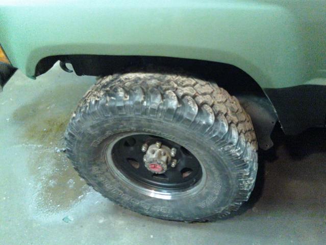

freshly painted
heres my 87 just painted it Tuesday night. tell me what u think. its a flat green and i sprayed bedliner on the bottom and on the rims. looks awesome. i sprayed 5 coats of it myself in my garage with a borrowed spray gun that was awesome to use. the over spray etc was minimal and smell wasnt bad at all. i had a window open and a fan blowing to keep the smell from going into the house. All in all im very happy
oh ya i got a steal on the paint. 20 a gallon. and yes its automotive paint. and i still have half a gallon left. spent a total of 100 on supplies including rust repair.

@ Bone, is that a 2WD bed, or do your wheels just stick out alot?

peow... it could be a 2wd bed. im not sure. it was on the truck when i bought it. all i know is there is no rust anywhere on it and the inside is solid. bedliner coming soon
