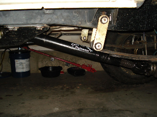

Picture; hopefully the angles at the pinion and t-case output are clear enough. Angle at t-case is definitely steeper than the pinion. I tried to keep the camera as level as possible. The driveshaft is definitely in phase. Also, I'm hoping now that I have a bumper and winch on it, the shackle angle will improve after some wheeling.

you have too steep an angle you're gunna get vibes

Originally Posted by myyota
You need some shims under the springs to change the pinion angle.
In order for the flanges to be parallel, I'd have to rotate the pinion DOWN. Is this normal? I know for CV drivelines, you want the pinion point UP toward the flange.
No way. This is NOT the answer. It leads to too much caster, and even worse driveline angle. Not to mention that when the leafs droop, the tie-rod will hit the springs and rub.
Scotty,
That's about what I thought too. What do you think about the angles from the pictures? I know that they're a little hard to see.
