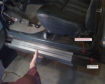

Slacker, any chance you have done a complete rocker panel removal and replacement??? I have new rocker panels that were bent for me but have been waiting to cut out the old and weld in the new because I am a little nervous... Any pics or advice on what I have to do to do it right? Thanks

Unfortunately I can't wait until then... I have to have it done by January for my inspection. Any tips on what I NEED to remove or how I go about removing the old??? Thanks

post up a pic of the panels you have ..

This is the panel I order from Mill Supply... but it was not correct because it did not go all the way back to the cab corner (picture is the one I sent Mill Supply showing them the part was not an exact fit). However, the new one I have does so I need to cut out the old and weld in the new... Thoughts? Thanks

quiggs.. based on the pics of that piece .. butt welding and spot welding would be best .. scribing the lines of the new piece first, onto the old piece .. and then remove the old rocker using a spot weld bit and a cut off wheel on your scribed lines .. Punch your spot weld holes on the new piece , and make sure everything fits ...
take your time with the welding .. space them out , and let things cool .. no warping aloud ..
and BE SURE .. after everthing is said and done , to "seal" your welds on the back side ..
