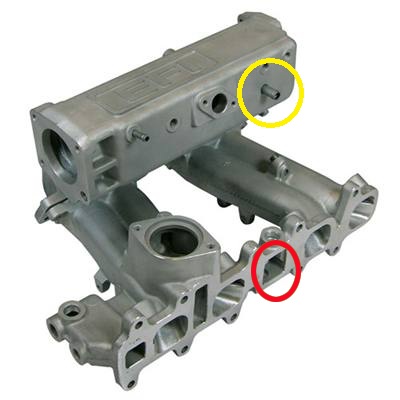

I need to figure out if those 'coolant pass-through' lines would spray coolant throughout the throttle body or just into certain intake manifold ports.
Originally Posted by xxxtreme22r
or the intake manifold gasket is leaking coolant from the heater supply between 2 & 3. But that would most likely only draw coolant in to #3. Not both.
where I have the red circle.
Thanks. I'll need to take a closer look at everything this week and hopefully see the obvious problem.

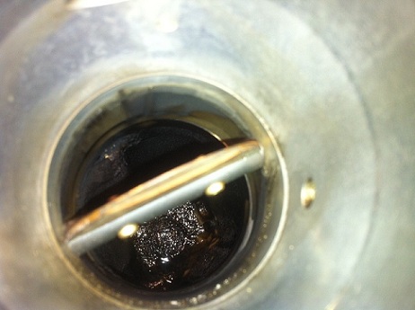

This is what surprised me - I opened up the butterfly for the throttle body and I saw a ton of moisture which I'm sure is from the coolant.
This is the best picture that I could get. The worst of it was around this which goes to the PCV valve IIRC (in yellow)

I looked at the intake manifold again and all the ports look really clean but 3 and 4 seemed to be the ones with more signs of coolant... The only thing that comes to mind is the engine\intake is tilted back so anything would 'flow' back to these two...
So... is it the auxillary air valve with a bad seal that is letting coolant into the throttle body? I think that's a reach as I've never heard of anybody actually having this problem?

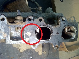

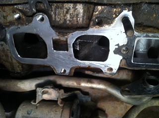

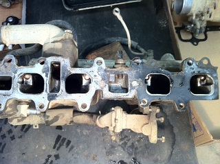

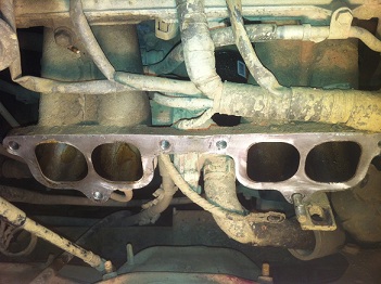

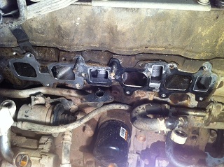

So I ripped off the intake and it looks like the intake gasket failed at the heater supply port and the coolant made its way to # 3 and # 4.

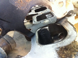

This part of the gasket was 'bubbled' up so I'd say that's where the coolant started to flow into the intake. The gasket wasn't attached all that well either - it just peeled up.
So it looks like the headgasket help up after all - any thoughts?

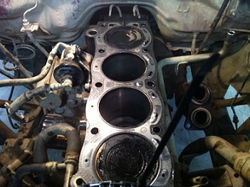

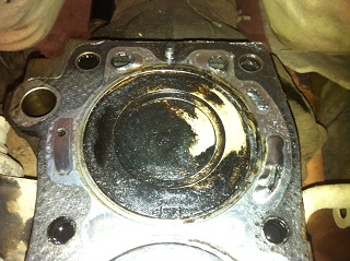

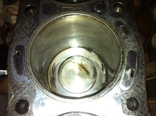

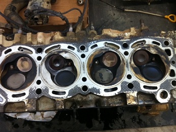

Well, it was the headgasket after all.
I see it failing on the exhaust side of # 4 and # 2. The fire ring on # 3 also was starting to look mangled but wasn't leaking yet.
I still don't understand why this happened so soon. One thing I will focus on is keeping the engine running cooler - the clutch fan needs rebuilt which hopefully fixes the gradual temp climb during low speed + high RPM climbs\snow runs.
To do :
- Take head to machine shop
- Toyota Head gasket this time
- Re-use ARP head studs
- Scotch bright and thoroughly clean the block surface
- Check block surface for warpage

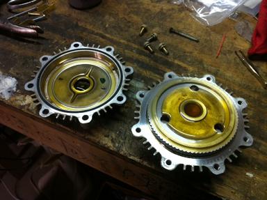

I rebuilt the fan clutch while I waiting for the machine shop to finish up the head.
It took 1 bottle of silicone - so it was a bit low (takes 3 bottles when completely empty).
There's more drag on it now when it's cold - it still seems to not be fully-engaging after the motor is warmed up. Wish I had a known working one to compare it to.

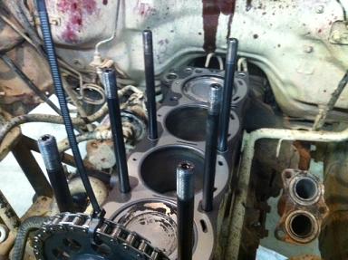

OEM Toyota gasket and ARP studs going back in. It's all back together and running better than ever.
