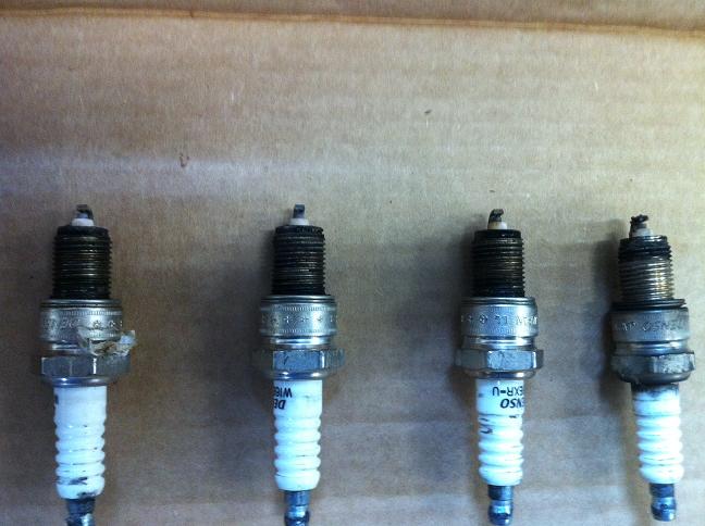

I pulled the plugs, throttle body, and valve cover - I was expecting one of the plugs to be very clean but they all looked the same, the one looks a bit different in this picture though. (They are in order; the first plug is the # 1 cylinder).
- There was moisture under the oil cap but not much - there were no signs of water\coolant in the oil or on the valvetrain.
- The ARP nuts for the studs were all still torqued properly so I was happy to see that.
- I noticed coolant in the intake manifold for the # 3 and # 4 cylinders.
that's not from a bad head gasket.
Sounds like the membrane on the coolant pass-through in the throttle body is leaking. I found a thread on this the other day.....let me do some searching....
or the intake manifold gasket is leaking coolant from the heater supply between 2 & 3. But that would most likely only draw coolant in to #3. Not both.

a headgasket will not put coolant into an intake manifold. Unless you have hydro-locked the engine and completely filled a cyl with coolant. Which is theoretically possible, but very highly unlikely.
