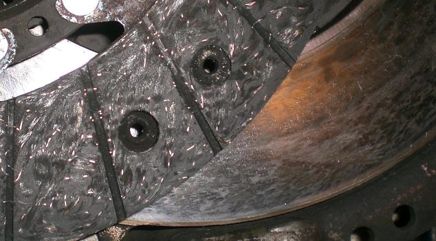

Has anyone ever tried this? Is it worth it? Wise?
The clutch disk on my 3vze seems glazed, and rather than order a new plate I thought I might try to resurface or deglaze the disk.
I have a 6 in palm sander and fine grit sand paper but im not sure how much margin for error there is or if it is possible....I cant find much info on how to deglaze a clutch disk. Maybe everyone just rather replaces it

I would just replace it while its out unless you were on a super budget

Buy a new one..
don't try and mess with it, because you don't have machine shop ;level of accuracy in a hand sander lol

Your pressure plate didn`t look to good either!!
How does the flywheel look??
As cheap as the kits are now I would replace it while it is out .
By hand you would make it worse .
Back in the day the used to put new lining on clutch discs but it got to the point it was cheaper to just buy new.

resurfacing clutch disk's is out. buying new is in.
same idea as alternator's, people used to re-build them back in the day, but now with the ease of finding parts, and the availability of parts, its eisier just to go with new.
i cant even remeber the last time i got my rotors "cut". ive just been gettin new ones

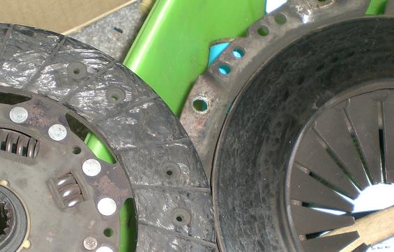

I had to indulge myself though and took solvent and a green scratch pad to the clutch disk and it looks alot different now... kinda messed up what do you think? does this look usable?

the flywheel looks just like the PP, and wasnt oily or anything

i always scuff the flywheel to break the glaze when i install a clutch,technically the right way is to have it cut then shim the flywheel for the difference but ive done this over half a dozen times with good results.I personally would not reuse a clutch i would install new one,recently put one in my yota i think it was less than 150. for the whole kit

if the flywheel is warped it'll need to be resurfaced... the clutch might not grab as good after that and the pedal position will be different... if there are heat scoring, the flywheel is junk as it'll warp again or cause chattering
flywheels are cheap, just replace it!

the clutch disc looks to be in awesome shape, just re-use it. Any sandpaper laying around for the flywheel is just fine. Slap it back together and dont worry about it, you've got another 3 years or so left on that clutch

You sound pretty confident, leave the last word to be the contrasting opinion! You are talking about the cleaned disk right? It looks like i got the glaze off but i dont know how the integrity was affected.. And i cant find a picture of a used clutch that looks like that with the copper looking strands visible. That looks like a healthy clutch disk then huh? everyone else says throw it away lol!
The flywheel however, upon closer investigation, is heat stained and cracking so thats a no brainer.. i wish i hadnt just intalled the fly bolts with loc-tite!

Put it this way, regarding the flywheel... How did your clutch feel before hand? Did your clutch pulsate? I'm talking about the friction point of 50%on/50%off the clutch when you are engaging in 1st gear. Like... did it feel like warped brake rotors? If not, slap it back on. I've seen many flywheels DARK blue, cracked, warped etc and obviously those I'll resurface.. but any older flywheel is bound to get a few heirline cracks. Just take the glaze off of it DONT USE A PALM SANDER. Sandpaper and a block of wood is just fine. I realize its a absolute PITA to pull the tranny's out of our trucks, and its hard to justify using a old clutch, but yours still looks like its in awesome shape and I wouldnt bother. By the time you buy a new clutch KIT, resurface the flywheel etc the price is going to go way up. Even just buying a new disk is risky because the flywheel and pressure plate are "warn to the disk" and adding just a disk could cause it to grab improperly and slip.
Lol, if this makes any sense. JUST USE THE OLD CLUTCH!
