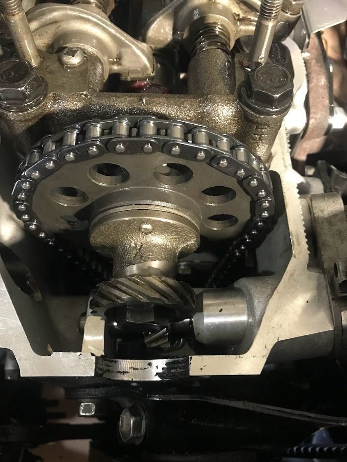

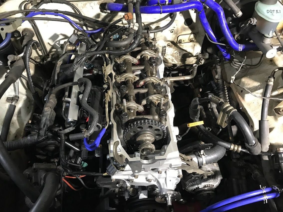

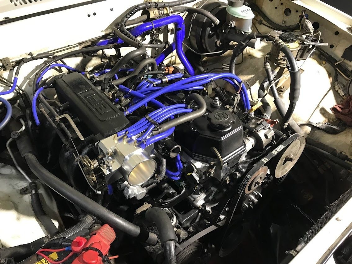

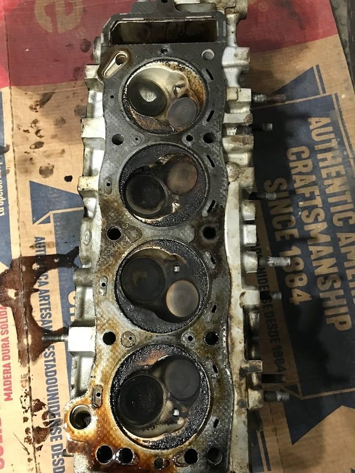

Cheap PO head gasket failure. Cylinder #4 was drinking coolant profusely.
My budget head gasket (sourced by the PO for a rebuild after his chain guides failed and the chain wore through the water jacket) blew last February in -15°F temps in Wisconsin. I sourced a new head and RV cam set up from these folks
https://sunwestautoinc.com
They also sourced me a recommended head gasket (Star I believe is the mfg) with vyton (I think) coating on both sides to assist in managing the differential expansion of aluminum and steel.
After about 8,000 miles behind this head and cam, things are still going well.
If your rig is a keeper (like mine is) then investing in a full top overhaul could be a great investment and you'll only be messing with everything in the timing cover, chain and head only ONE TIME.
If you have the budget, I'd recommend doing it all once and enjoying a very long "uptime" on your rig without issues.
Things to consider when doing this are the really hard to reach items like the fuel filter and the starter (I had mine rebuilt by a custom starter/alternator shop, I also gave them the alternator too just for good measure).

That engine bay looks really good. Thanks for all the options everyone.. I'm hoping to be able to knock mine out after the holidays when I have some $$ to throw at it. I hate it that the truck is just sitting..

Thanks, it took a little bit of work and searching for the blue components. I'm adding an LCE spark plug wire separator plate soon
https://www.lceperformance.com/Bille...-p/1085006.htm
