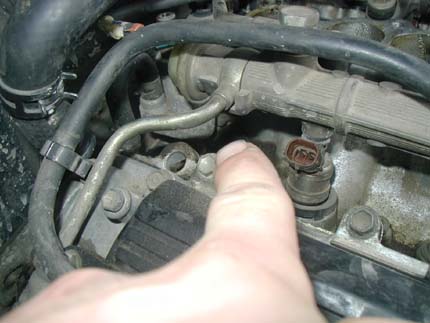

Alright, well i thought I could get through my 3.0 head job with just my engineuity (little joke there), the FSM and all of your guys old post and threads but alas I've hit a snag. When removing the right (pass. side) fuel injector fuel rail, at what location do I dis attach what must be the main fuel line? It is the large union connector on the firewall end of the passenger rail leading down to gas tank. Also, even with many a search performed I still am no closer to removing both the cam pulley bolts and hence the pulleys themselves. Any suggestions there would be great. I will try a strap wrench today. Just to clarify a post i read saying to put a 10mm socket on the fastner behind the pulley (you know, one of the bolts for the rear timing belt cover) to imobilize the pulley while you loosened the pulley bolt seems to bring undisired consequences i.e. the head of the bolt getting all messed up. Even if you were to be extremely careful, following that process through to its end result would mean disaster. PICS of fuel rail with connector in question will follow! THANKS
P.S. where is the oil return hole that you all say to plug with something so stuff doesn't fall down in there?

Heres a pic may help.

I've done this so many times and I don't ever remember there being a trick to this. If I recall I just used a big wrench with a rag to hold the fuel rail in place. Unfortunately with the air plenum in the way I can't get a better visual to remember exactly.

On the fuel rail, I left the part you're pointing to hooked up. I removed the pipe that connects the 2 rails in the front and removed the bolt holding the rear pipe to the rioght side rail and that gave me enough to remove the 2 rails.

Thanks for the info. everybody, I now know where to take it apart at. Scuba sorry about the name thing, not intentional by any means (by the way do you know of the wreck of the Diamond Knot? Great diving if you are interested!)
