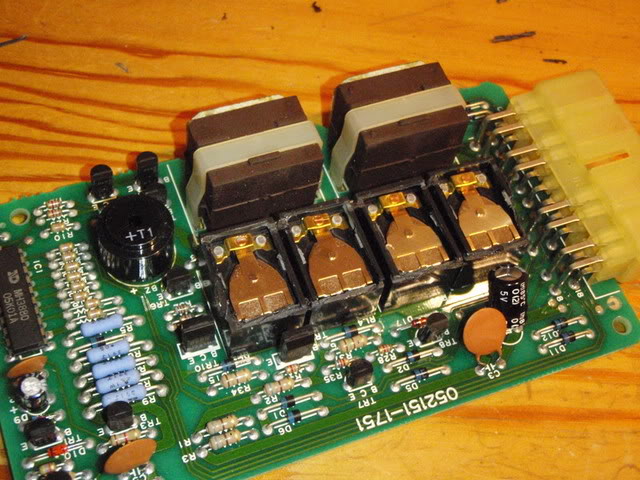

Window control module relays
The control module is located by the tailgate on the driver’s side. It is just back from the storage compartment. Pull back the panel and you will see two bolts connecting the module to the body. Unbolt, unplug and remove the black box. Here’s a pic of the location with the module removed, and the connector showing (white rectangular connector to the left of the cubby about halfway down the cubby).
Here is the black window control module (relay box):
P2030080.jpg?t=1202697162
I tried cutting the tops of the relays off and cleaning the contacts, but this did not work at all. I wouldn't bother. Some people have simply swapped the wiper motor relay with the window motor relay. The wiper relay is in better condition usually because it is not used as heavily. It would probably work, but your wiper would be compromised.

I called around to see if I could find replacement repairs from the OEM (Omron). However, I was told that these Omron relays were specially built for Toyota and you cannot buy them. The electronics part store (Main Electronics in Vancouver, BC) were very helpful and found a 5 pin relay that is smaller and would fit. It also has a higher amperage rating of 10A which should it should last the life of the truck.
Open the black box up and you will see the relays and assorted circuitry. Going from left to right the functions of relays are
1. WINDOW UP 2. WINDOW DOWN 3?4? (Please tell me if you know which is which)

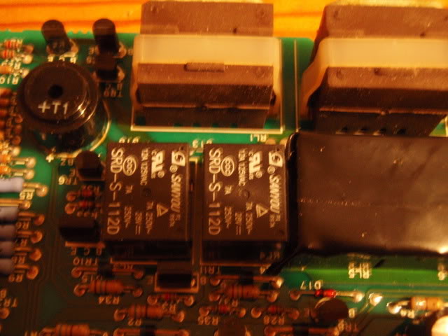

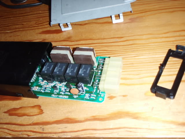

Basically, you have to remove the two relays (black boxes) closest to the black cylindrical bit on the left side of the photo below. I used a spring loaded solder sucker. I then soldered on the new relays, which are smaller, but heavier duty.

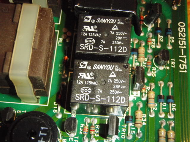

Here are the new relays, they're made by SANYOU. The part number appears to be SRD-S-112D. They are smaller than the OEM relays and fit just fine. The pins are in the same positions and its simply a matter of removing the old and soldering in the new relays.
Reassemble and now you should have a working rear motor. My window goes up in about 5 seconds now. Anyways, it works a lot better and didn’t cost much.

I'm a bit confused by the photos and text.
Did you mean "left to right" in the 6th photo?
Did you mean the "black cylindrical bit on the LEFT side" of photo 7?
Are the Sanyou relays in Photo 8 the window relays you replaced?
Just out of curiosity, what's with the black cover over the other relays in photos 7 & 8?
Thanks!

DCS I meant left, pardon me. I used a different set of photos than I originally intended.
The carpeted cover just pops off, I just grabbed it by the corners and yanked. Not difficult.
Denk and Kellhammer, I've edited it now:

DCS, the black cover over the two other relays is electrical tape. I opened them all up in order to see which were involved the operation of the windows and to see if I could clean the contact. I could not do so, thus I replaced them.

I called up a local electronics parts store and described the relay. Here's the description of the relays used:
12-volt miniature automotive
PCB relay with 5 pins
320 ohm coil
approximate OEM dimensions: 22mm long X 16mm wide X 15.5mm high
From this site: http://www.geocities.com/dkwalker/te..._relay_fix.pdf

A direct cross to the Omron relay is a NAIS JS1-12V-F. It's available at Digikey.com and here is a link to it.
http://search.digikey.com/scripts/Dk...me=255-2080-ND
I have literally thousands of these out in the field in automotive applications I've designed, and never had one fail. I use them in remote locking, power window, remote electric bed covers and alarm applications.
Infact, I'm posting this because I just found this thread after doing this repair with these relays myself.
