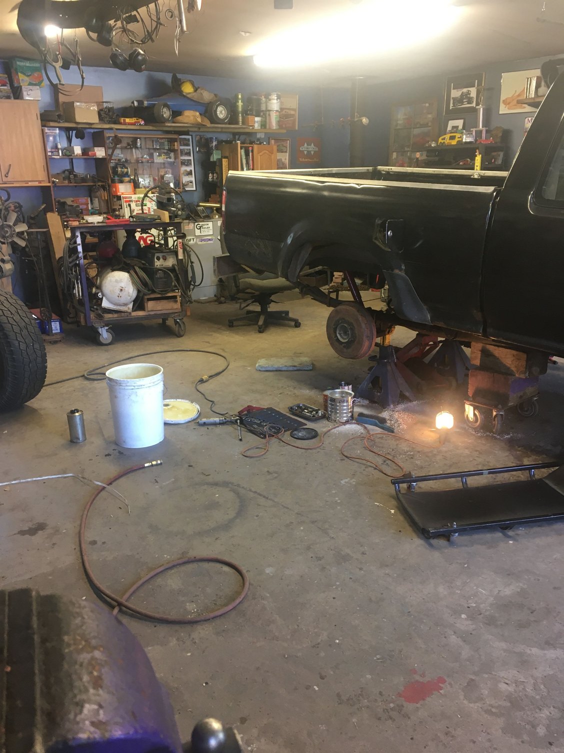

Not replacing drums unless they chatter. Also replacing crossmember that supports fuel tank/exhaust. It’s rotted in Center. Must be trapping moisture
New piece, not quite same diameter but it’s what I had
Rotted section,,

So while i was doing this work i had bent a 30 year old brake line to do some welding. The line was weak there and started leaking so this weekend replaced about 5' of brake line (up and over fuel tank) , 2 ' of the line was very crusty, the remainder solid and like new. Had to unbolt fuel tank to access lines and then make my own lines to install....the buck is TONY(similar to fluid film but way cheaper) Sprayed lots of that in areas tough to access when fuel tank is anchored. I had also added new rear shocks while doing brakes the other week(Gabriels). One shock was broken, grinder accidentally punctured the other shock
