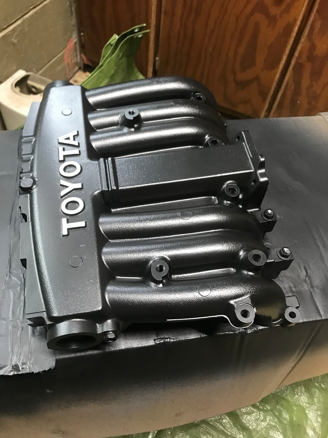

I’m trying to maintain the original engine, it was my dads and I’d like to use that engine still. Plus I’ve had head work done and a new intake for the engine too. I’ve spent a lot of time cleaning and painting parts for it.
