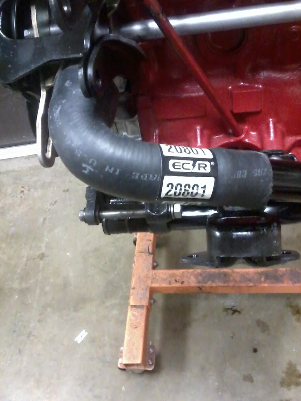

Your lower hose is ready to pop. I would check the hoses under the plenum as well.
I use Gates Rubber hose PN# 20801, around $10. It comes is a "S" shaped form, but when you cut the lower part off, it looks identical to the original and has the larger opening coming off of the water pump and the smaller end for the horseshoe pipe.
Gates PN#20801, just cut off where my finger is at. A lot cheaper then the dealer.
Here it is cut to length and on. I need to get some new hose clamps to finish the job.
