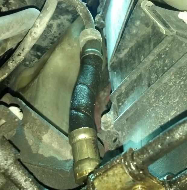

Just got my first ride, a 1990 4runner and I'm hoping to get into the whole forum deal. Been looking around and there seems to be a lot of cool people with plenty of know how. So i figured id give it a shot...
Located the power steering leak. But I'm afraid to just replace this hose. (The vertical black one) be great if you guys could just tell me what I'm looking at. I have no idea whats inside of it? if anything? Besides the power steering fluid thats ending up on the driveway...
any insight would be much appreciated. thank you!

Power steering hose is just what it is Power Steering.
Nothing to complicated only the fluid very messy to change just make sure to use the correct fluid when putting in the new fluid.

I may be over thinking it, but what is the point of that fat hose? goes from a hard line to that. Why not just put a hard line all the way through?

The rubber part helps to absorb a lot of the vibration and helps the hose to flex as needed.
That is how I look at it what the real reason is could be completely different.
it could also be easier to fabricate the hose like that.

Yep to absorb/allow movement. resi' is cab mounted pump is engine mounted steering "gear" box is frame mounted.
