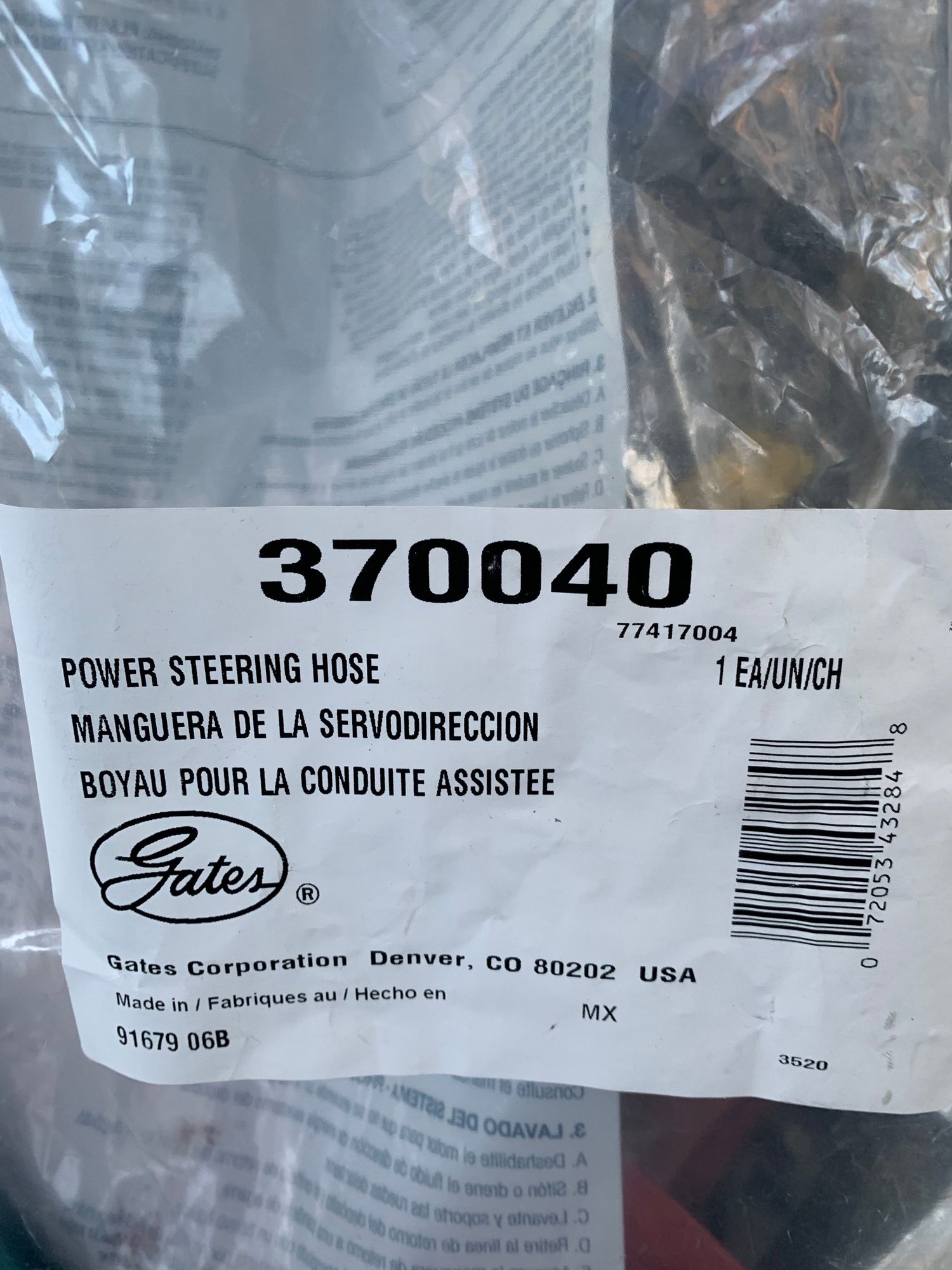

For the power steering, I got a the pressure hose online from https://www.autopartskart.com/ for $48 (including shipping). Its a Gates #370040 for anyone that is looking for one. Also replaced the return hose using the most of the original hardware.
