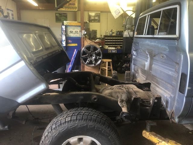

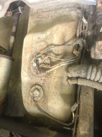

Thank you so much for all the info. I ended up getting a tow to the mechanic. The tow (dragging the truck onto the flatbed) broke loose the seized e-brake. I had lost a brake line a few days before while trying to get things working. I tried many of your suggestions but no luck.
The mechanic took off the bed and it's obvious we need a new fuel pump. Expensive-now on the hunt for these parts.
