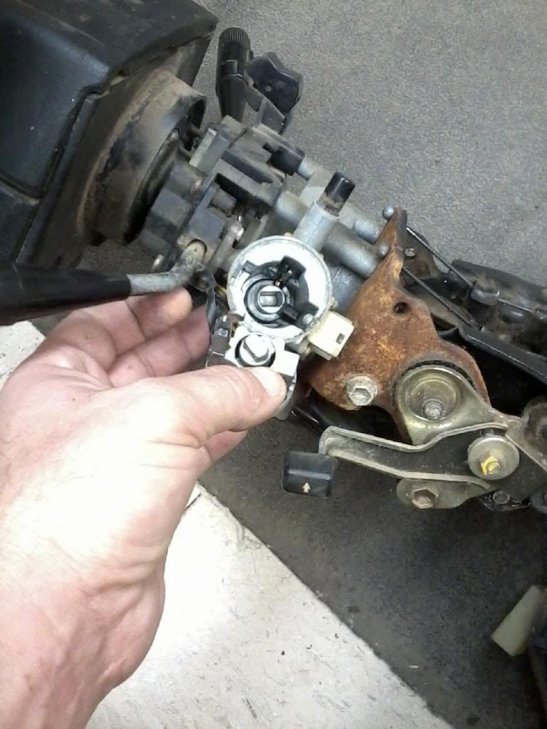

I have had similar issues. Truck would shut off or have to jiggle the key to get a good contact. Below is an 84-88 truck but yours should be similar in removing. The electrical cable can be replaced as well on these that hooks to the back of Ignition Switch. If I recall right, there are just 2 small screws that connect it to the Ignition Switch and it just plugs into the Steering Column harness.
To remove the Ignition lock, you have to have the key in the ACC position for it to slide out of its assembly. Once you have it in the ACC position, there is a little tab that you push in to let the lock slide out. Not sure where it is on your generation of truck.
Copied...
you turn the key to the Accessory Position and push in on the silver button and pull assembly out. I use a nail or something similar to push the button in.

Since your key wont turn, I would try a several other keys as a last chance effort, if that doesn't work, my suggestion is to drill out the key slot to get it to let the tab that engages the slot inside the steering column to turn. You have to get it to turn to remove the key assembly.
Beckley Arnlay seems to come to mind for a key set off of ebay or the parts store could get you an assembly I think. This is how I would do it if it was up to me. I have heard of this happening and it does take a tow truck to get it home. Others might have a better way. Never had it happen to me but it did to a friend of mine on his 94.
Here is the key cylinder upside down showing the tab (by my thumb) that engages the slot inside the column.
