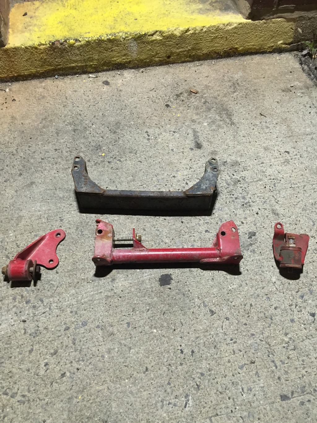

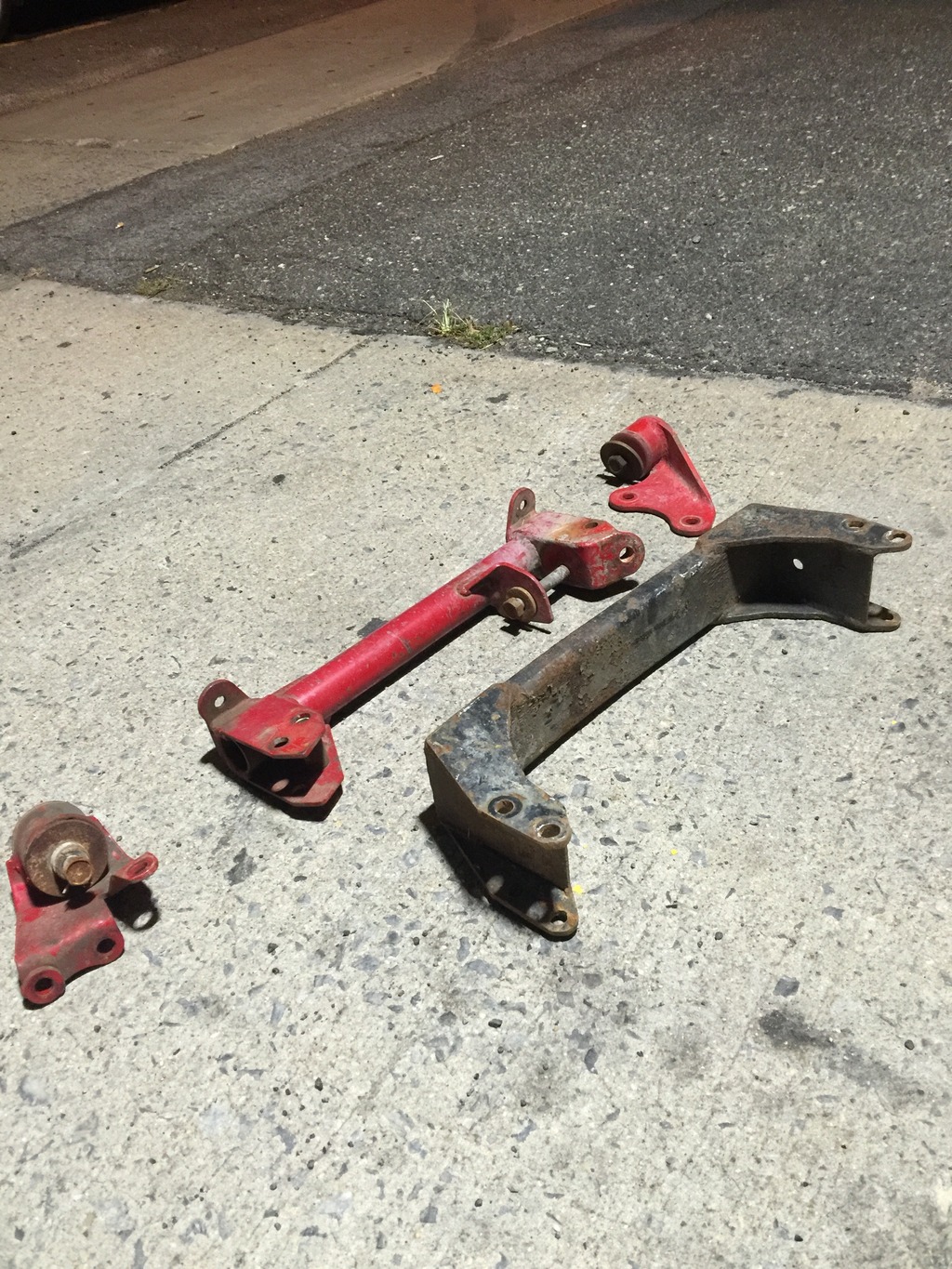

A few nights ago I stopped by a friends house to grab some parts he had. And he threw these into the deal. It came out of a 88 4Runner that rolled over. He didn't pull the control arms since the right front wheel had hit a guard rail causing it to roll. So he assumed it was bent.
Now what I would like to know.
1. Which kit is this from?
2. Identification of the two big brackets. One looks like the crossmember drop. I'm going to assume the other one is a truss?
I know the two smaller brackets are for the diff drop.
3. Would I be able to use any of the stuff without the control arms from the kit? I know there's also supposed to be a sway bar mount drop brackets but I could fab those.
I was planning to run a BJ spacer in the front with a slight torsion crank for lift. So was wondering if I could benefit from any of this stuff in conjunction or buy itself.
Thanks!

only thing useful is the dif drop brackets. need a lot more parts to use that 4 inch bracket lift. missing the spindle brackets, special bolts, etc etc. all the bracket lift kits are pretty much the same. compare those kits to what you have.

Its a rancho kit. talk too blazeland (A.KA. blazN8), he knows alot about it.

Yep, its Rancho. If your friend would have been able to get the whole kit it may be worth messing with, but since its just diff drop brackets its not worth it. Type in "Ranchoda" in the search and you will find the information to explain things.

Thank you! I probably won't use any of this stuff now. I was hoping something would be useful. I'll keep it around if anyone else needs it.
