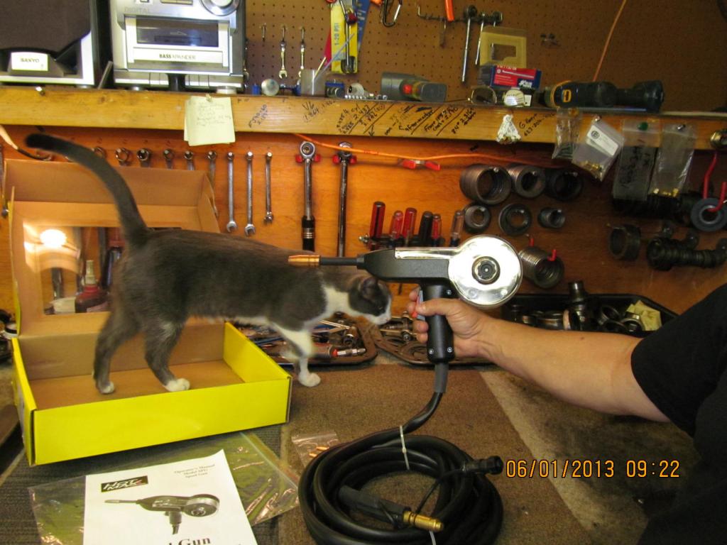

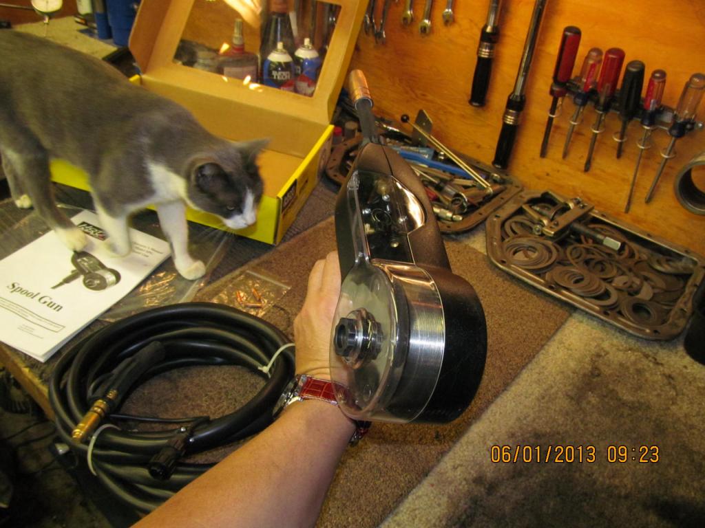

I researched using a spool gun as a "poor man's wirefeed welder" with google and nobody has ever documented ever never not in the least no-way using a spoolgun as a trail welder....so I tried it and I likey!!

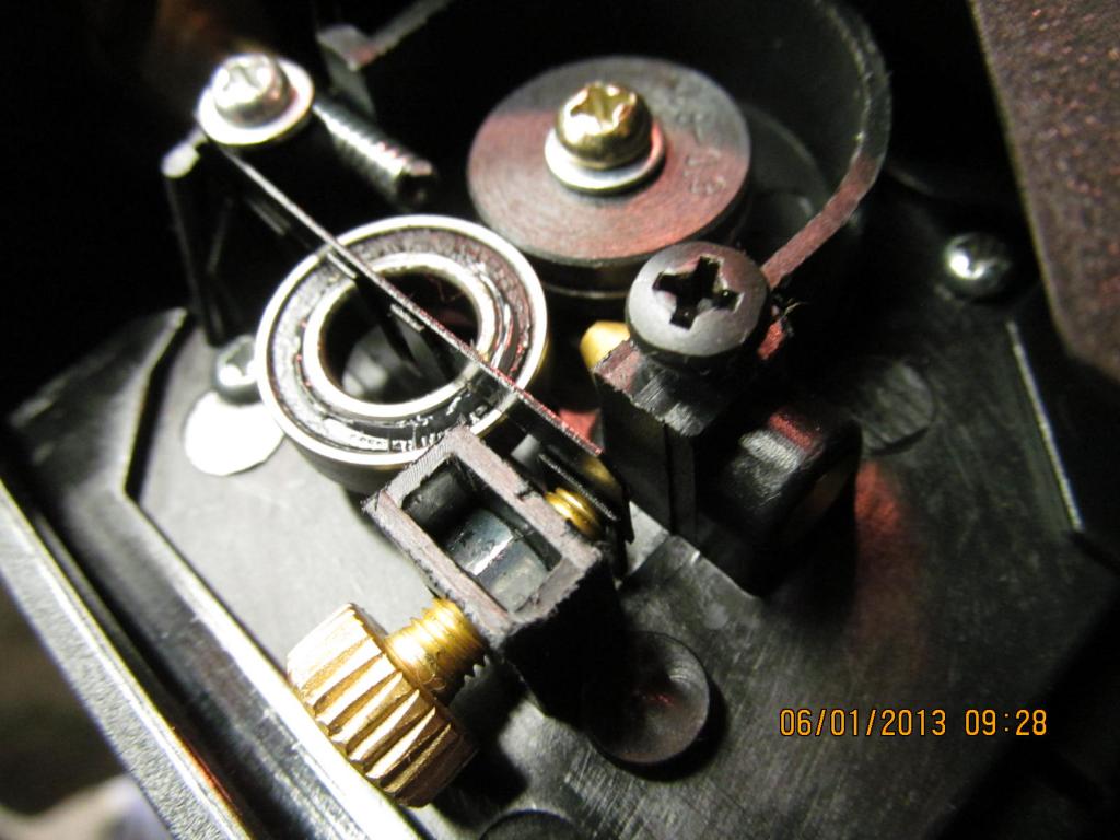

I bought the cheapest spoolgun I could find(about $120)....so the quality of the wirefeed mechanism might not be the best. The spoolguns make use of the wirefeed controller on the main welder....so something has to be done to get the right wirefeed voltage to the motor when used in the outback. I addressed that with simplicity. I show the LM317 integrated chip below but never mind that....not everybody is an engineer and I like to keep it as simple as possible even for my own use. see below.......

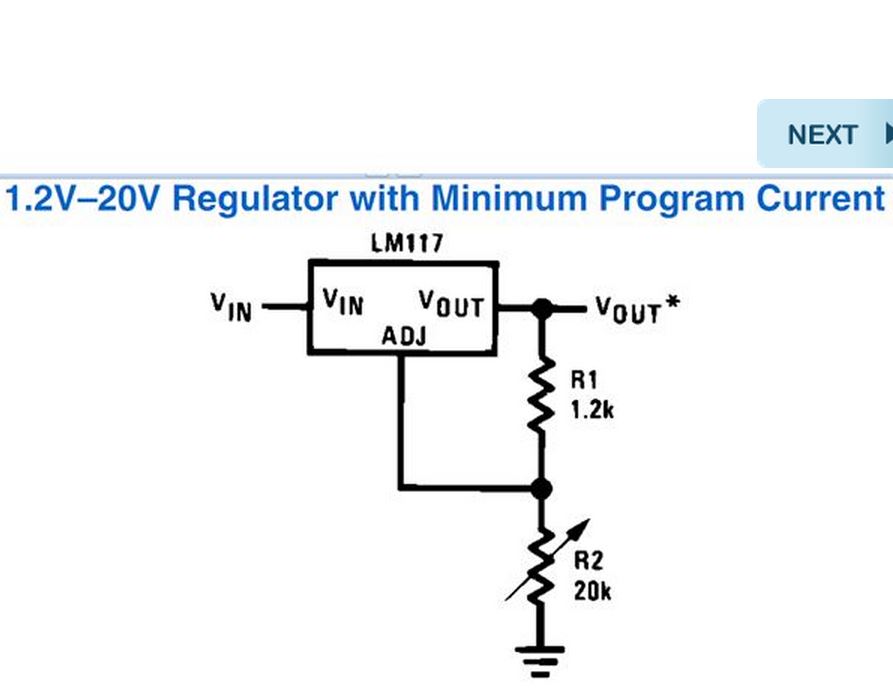

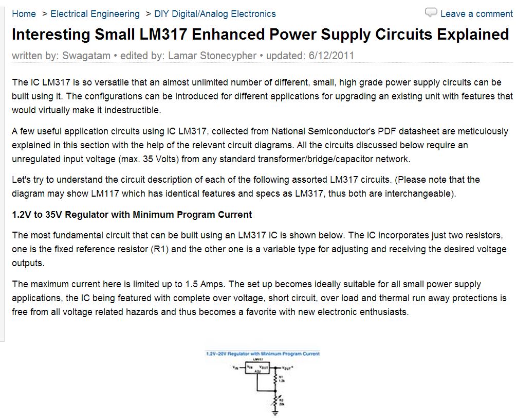

Planning on converting this spool gun for trail use. 030 flux core steel wire is the plan. Just have to make an LM317 IC the variable voltage
source for the wire feed controller. Preliminary tests (No wire, No load) indicate this wire feed motor operates in
the range of 3~9 volts dc and draws 160 milli-amps.
Looks like I have myself a $120 trail wirefeed welder
The 24 volts is just fine for 1/8" to 1/4" mild steel. In the interests of simplicity, instead of the LM317 voltage chip for the wirefeed control, I chose to experiment with small AA batteries.... 4.5volt is too low.......6.0 volt is just about right.....7.5v is too fast....and this is for 030 flux core. So, this means no fancy variable voltage circuit is needed and I can see 4 c cells doing a nice job for. If using larger full sized truck batteries then that means the welding power goes up and 4 c cells is a little slow so 5 or 6 c's should more than do it. Buy a C cell battery holder....one that holds up to 6 cells and you're all set for all situations.

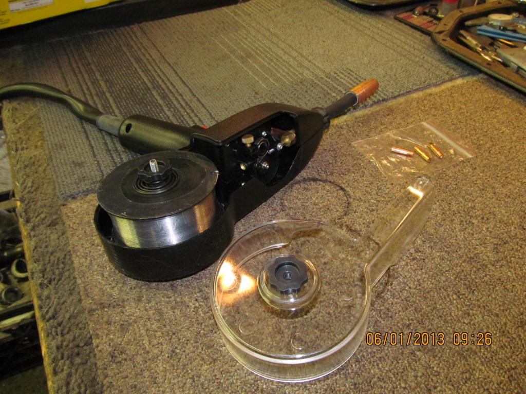

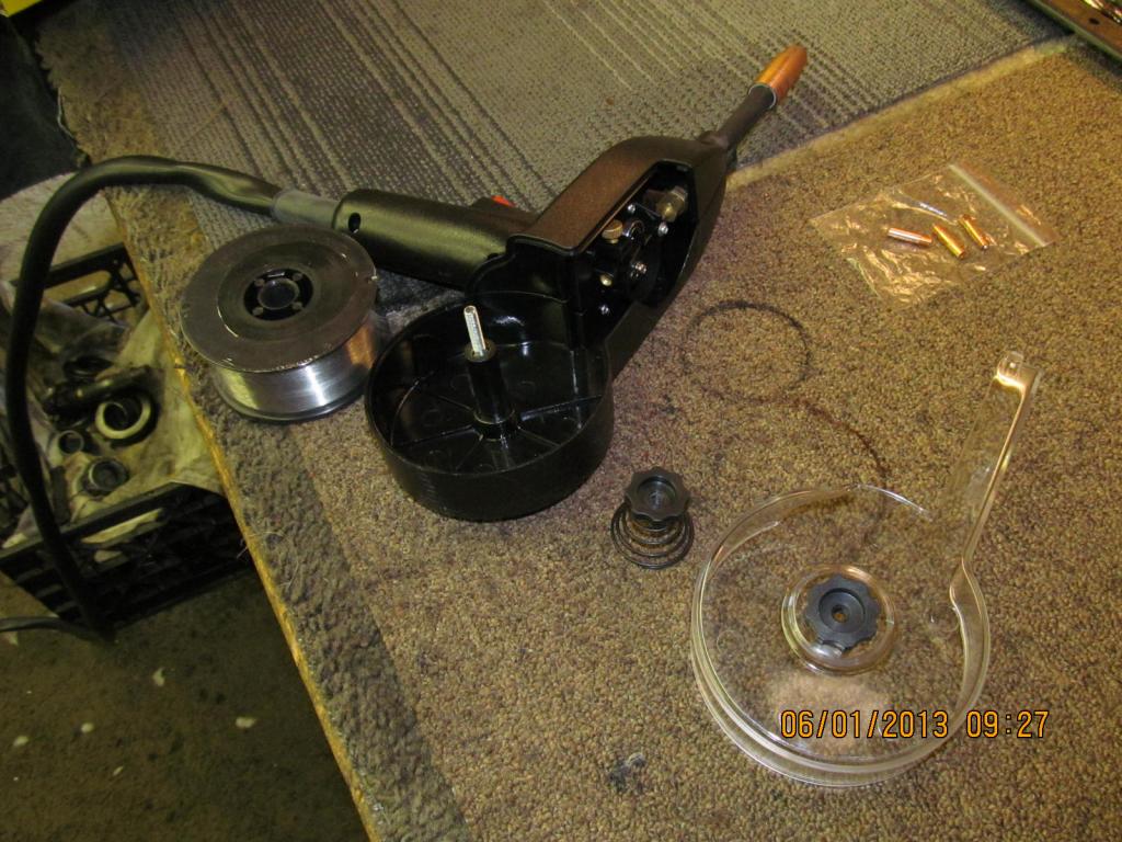

Wire is loaded up.
I've had this 1/2 spool for 10 years now so it's time to use some of it.
