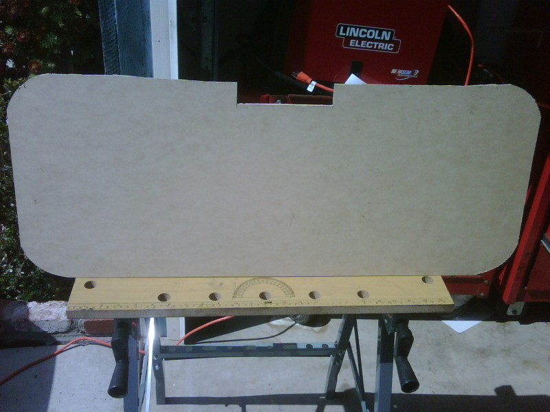

Do you have a factory popup sunroof ?. I layed a piece of flat steel from end to end to to re-enforce it. I did not take a pic after laying out the steel brace but you can get the idea from this.

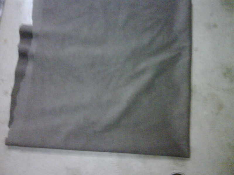

Originally Posted by jslone
Is the bottom covered with something?
Thanks Outsane

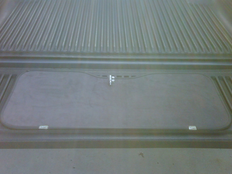

And yes, I covered the bottom or interior side. I got some material form an upholstery shop next door to my shop. Pretty close to match my interior.
Here it is finished. Used a flexible self adhering door molding for trim.

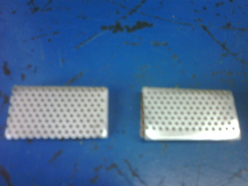

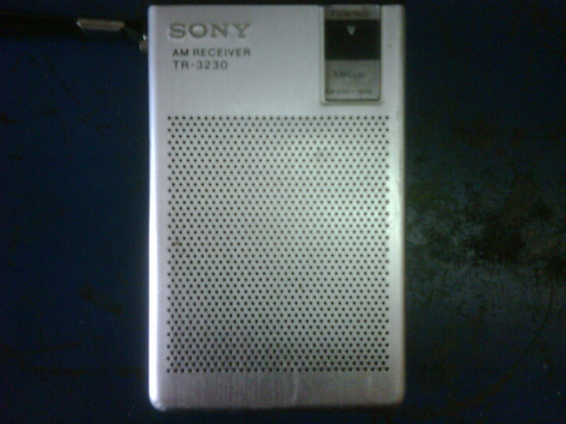

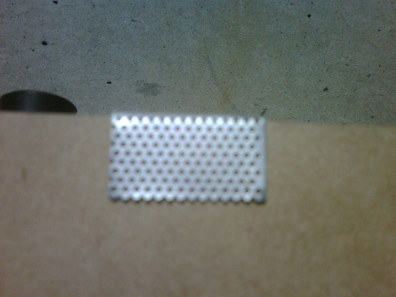

Thanks much guy's, Its was a fun and not so hard to do. The creative part came when i had to make tabs for the cover.
Found this old broken radio and removed cover to make tabs.
The metal was just the right thickness so it slides right in the tab holders on the sunroof.

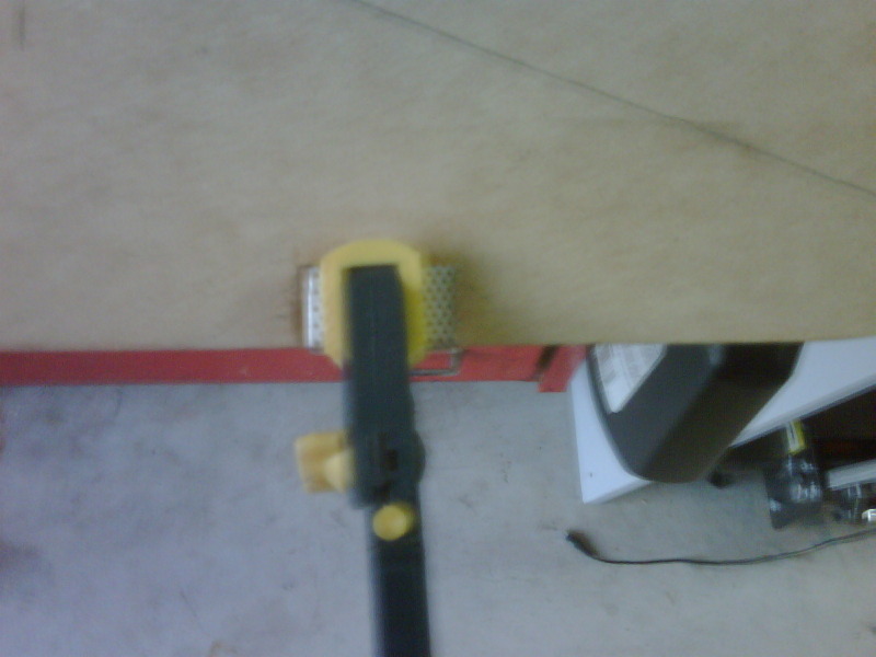

Forgot to add this pic. Epoxied tabs from radio cover to masonite board.

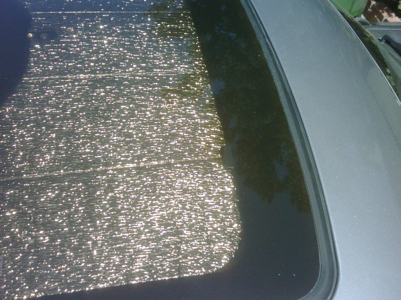

This thing works great, starving off alot more heat then I thought.
