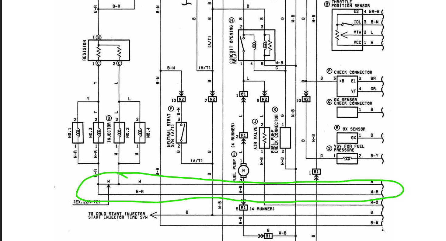

Hi, Pls refer to schematic below.
When IGN is on, there would be constant 12V on positive sides of the injectors. There are 2 wires (enclosed in green) coming from ECU that provides ground pulse to the negative side of the injectors. That controls injector pulses. They run under the intake exhaust manifold., and a few of us have found those with corroded/broken crimps .Please check those. Sorry I don't have my FSM handy and I don't remember which ECU pins, but they should be a white and a white wire with red stripe.

Thanks for the reply, i am assuming you mean under the intake manifold not exhaust manifold, i will take a look tomorrow when im at the shop. i noticed that diagram is for a older model with a injecotr resistor box my 93 does not have that but the wiring might be the same.. i will pull the manifold tomorrow and see what i can find

Sorry, yes, I meant *intake* manifold.
While u have it apart, pls consider rerouting wires that do not absolutely have to run through there for ease of future work.

didnt get much time to play with it today had a ton of work going on at the shop.. but by surprise a 93 manual trans pickup showed up for a smog check and i asked the customer if i could check something real quick.. i swapped my ignition control module with coil to there truck and it did not run there truck, i put there module into my truck and my truck still did not start but i didnt want to keep playing with it incase i have a wiring issue taking out the module.. put there ICM back in there truck and it fired right up.. i checked my truck for codes today and i am getting code 22, 24, 31,41 after looking at a few diagrams it looks like i definetly need to look into the wiring a little more specially the e2. e21 wire from the computer
