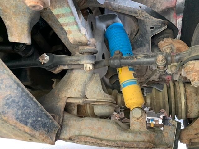

What jumps out to you guys

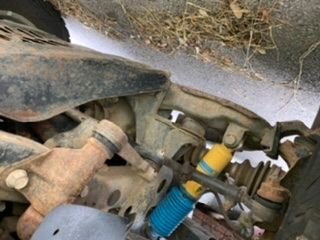

Old Apr 6, 2020 | 06:05 PM

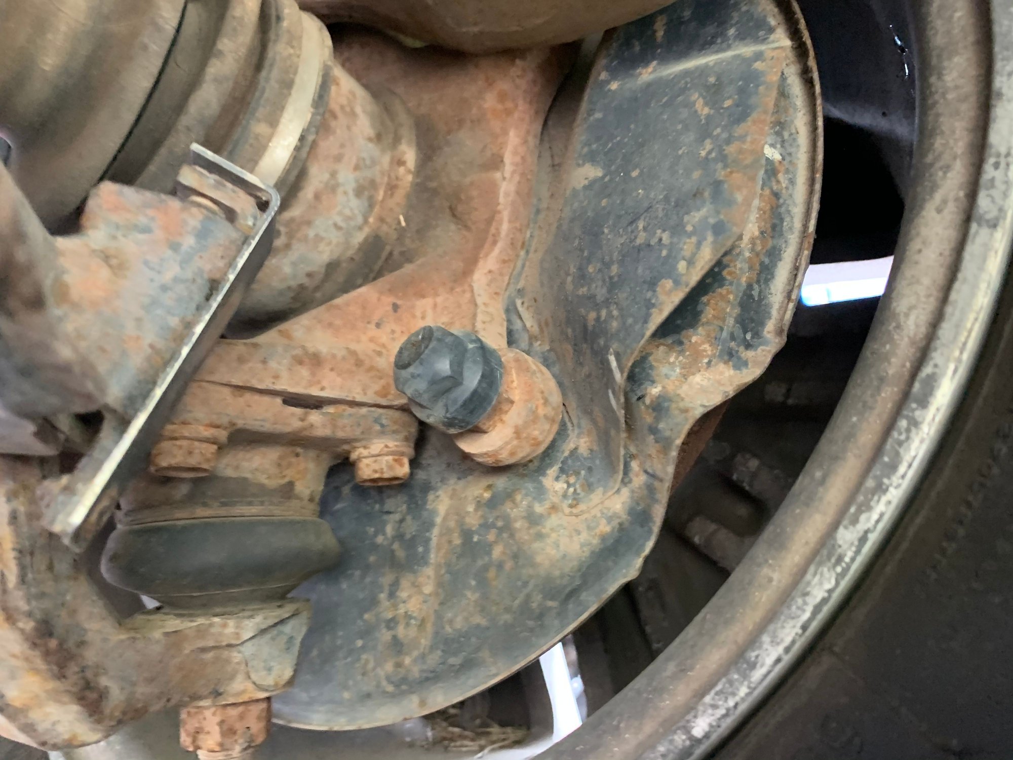

Toyota replaced a center link I believe about 1000 miles ago on a recall. Made issues of brakes and steering fluid (which I corrected since) but nothing about steering other than the center link.

Originally Posted by Spread5150
... ball joints and tie rods look like they are gonna run 624.00 from Toyota parts online. After 200k on the truck it’s prob about time.
Just inspect the ball-joints for play and lubricate if OK. I only replaced my uppers because they have play.
On our trucks with torsion bar, the upper ball-joints support most of the weight of the truck. The bottom pretty much just holds things in position. In fact, the old bottoms on mine still look better than my new OEM uppers that are already "sweating" grease.
Our ball-joints are under compression. If they have wear they would have play but are not likely to fall apart. They are so much UNLIKE the ball-joints on first generation with coil-springs where the lower ball-joints are under tension; Forces are pulling them apart. That's why they could just pull apart without warning.
Visuals woud help.
