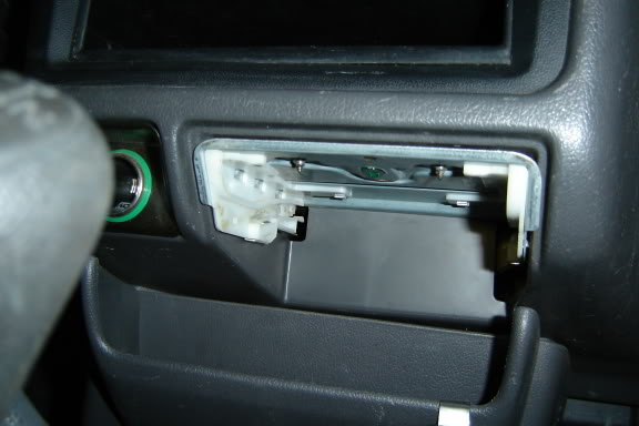

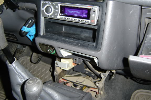

Ash tray out:

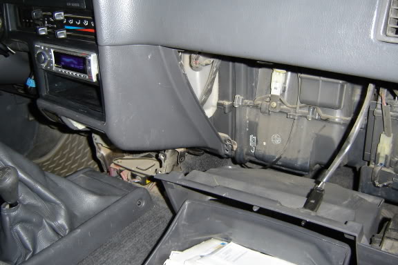

Glove box out:
Popped the ignition trim piece:
Pulled off the temperature control knobs and pannel:

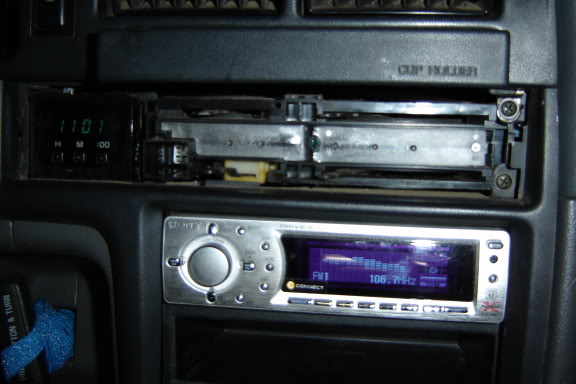

Main center trim piece out:

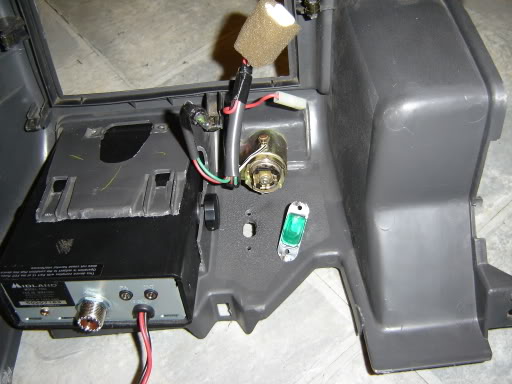

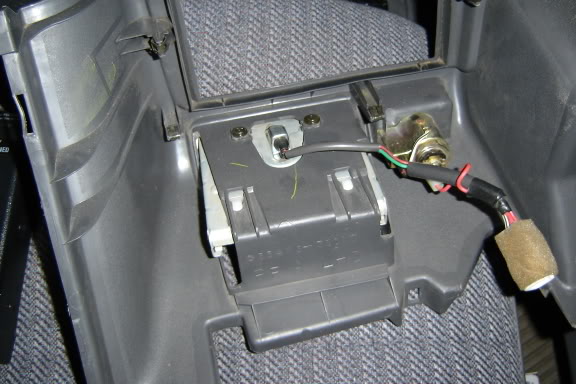

I've had this peice out few times before when i installed the head unit and i recently discovered that the ashtray light comes on when my head lights are on. So this is where i started thinking more than just the CB...

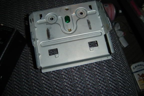

Ashtray/light bracket off:

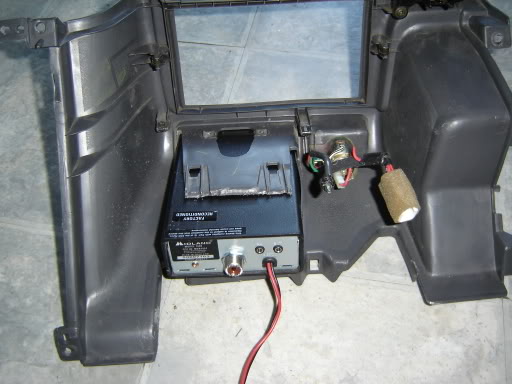

Setting the CB in place but now it's time for the Dremel:
Perfect fit:
I secured the CB by drilling one hole and it was enough to keep it in place. The next picture shows how it's mounted with one bolt.
I could'nt let the ashtray light go to waste so i came up with a plan.
I slightly grinded the rivets that held the light mount on the ashtray bracket and removed it. I then cut out a hole in the main trim peice (for the light) and more holes to mount it.
Light installed:
I used #6 hardware (3/8" flat head slotted screws, flat washers, and lock tooth washers) to mount it. The scuff mark you see next to the light was a mishap of the Dremel getting outta control:
