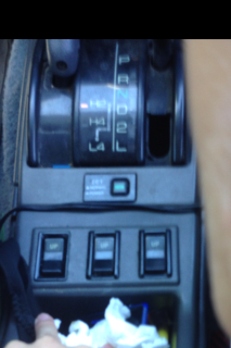

Still need a bit of help though. The goal is to put 3 switches in the center console to control each of the windows. My buddy was able to do it using the exact switches as the back window like in the picture underneath.

I want to have three back window switches in the center console. Just like the picture above.
I want the one on the left to control the drivers window. Middle to control the back window. And right to control the passanger window. I don't want to use the master switch anymore.

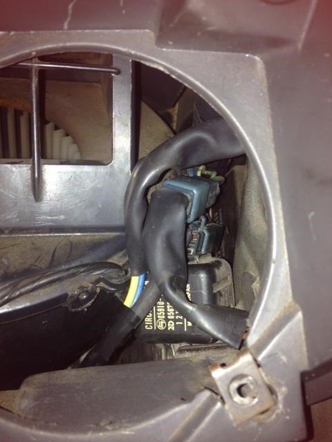

Is this the relay? Its behind the passenger speaker. There was nothing by the ECU.

That is your circuit opening relay.
Then given the age who knows where things could have been relocated to.
If I have time I will look and try and find the physical location if my old brain remembers.
It is the Door Control Relay
