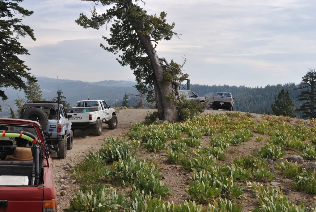

I run OME suspension on my 93. got everything from TRDParts4U several years ago and have been happy. I got Dakar medium leafs, 2x bushing kits, u-bolts, 4x shocks, 1x steering stabilizer, SDORI BJ spacers, and a Sonoran Steel IFS truss all from them. I chose not to get new shackles at that time because theyre in great condition and I didn't want extra height -- now I'd say I'm ready for some new shackles now that I've added more front end height to clear my tires. I'd recommend you make sure your idler arm bushings are in good condition as well as everything else up front like all your joint-ends, since you'll now be changing angles on everything - also, it'll keep the steering nice and tight. Firestone Lifetime alignment was a great investment for me wheeling IFS and making changes over the years, why pay more than once?
LSPV brackets can be easily made yourself, but if there's a kit then just get that it's faster (I think I actually just bent the arm more and adjusted the threads and it's been fine since it's not a lot of lift). Think about your plans for the truck - if you want to wheel a lot, consider getting a u-bolt flip kit now and install at the same time or you'll be buying ubolts twice (but you'll need a welder). For me, I noticed the stock shock setup was my limiting factor for flex - now that i've done the ubolt flip and triangulated the shocks, everything is better and i get several inches more down-travel -- also, the OME ubolts had VERY long threads and will need to be cut off after install or they'll hang pretty low under the axle and catch on everything.
IMO, a ~2" lift with 33s is pretty much the perfect stance for a weekend warrior toyota pickup. Recently found this pic of my truck from Squaw trip a few years ago - you can see the need for maybe 1" more in the rear (needs a 5.5" shackle) -- truck sits level at 22.5" from center of axles to bottom of f/r fender lips:

Thanks HighOP,
Are you running bigger torsions ?
Did you remove the sway bar ?
Nice pic, looks like a great trail !

decided to skip the larger OME torsion bars because I don't have a heavy winch+bumper up front to combat the extra spring rate. I also removed my swaybar because, again, there isn't extra weight up front and I wanted all the IFS flex I could get when out wheeling so I could keep my traction since IFS likes to 3-wheel and I have an open front diff - also, the stiffer OME shocks and new stiff leafs pretty much equalized out what the swaybar did for the old soft suspension. You can always add the t-bars at a later time. I think you'll be happy with the new suspension, just remember the leafs take a little while to settle so don't be alarmed at the height gain when you first install them (especially if you're sagging now)
Yeah, Sqauw Ridge was a great trail, but sadly got closed because of Environmental Impact Study or some BS like that since there are a few meadows that get driven through. I hear parts of it are open though.
