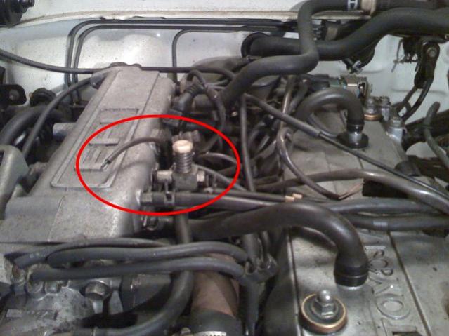

When I got my used 87, there was an extraneous temp (looking) sender sitting on top of the valve cover, just laying there. Poked around under the hood and could not find a place to install it. Found the gauge sender installed where it belongs and nothing else was within reach of the wire attached to it. But, alas, one day it came loose and fell out from under the hood on the road. Now I have a bare wire in its place. Pulled it up over the TB so it would be easier to see.
I've been debating whether I should replace it ... of course, not knowing what it was would make it difficult.
Joys of buying a 20+ year old vehicle.

i am pretty sure ( i cant see it anyways) that is the wire for the one that is drilled on top of the inlet tube or the one just above the thermostat. It looks like yours isn't there or just wasn't drilled. its either that or the one further back in the mid engine.
