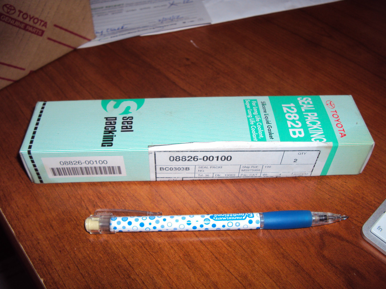

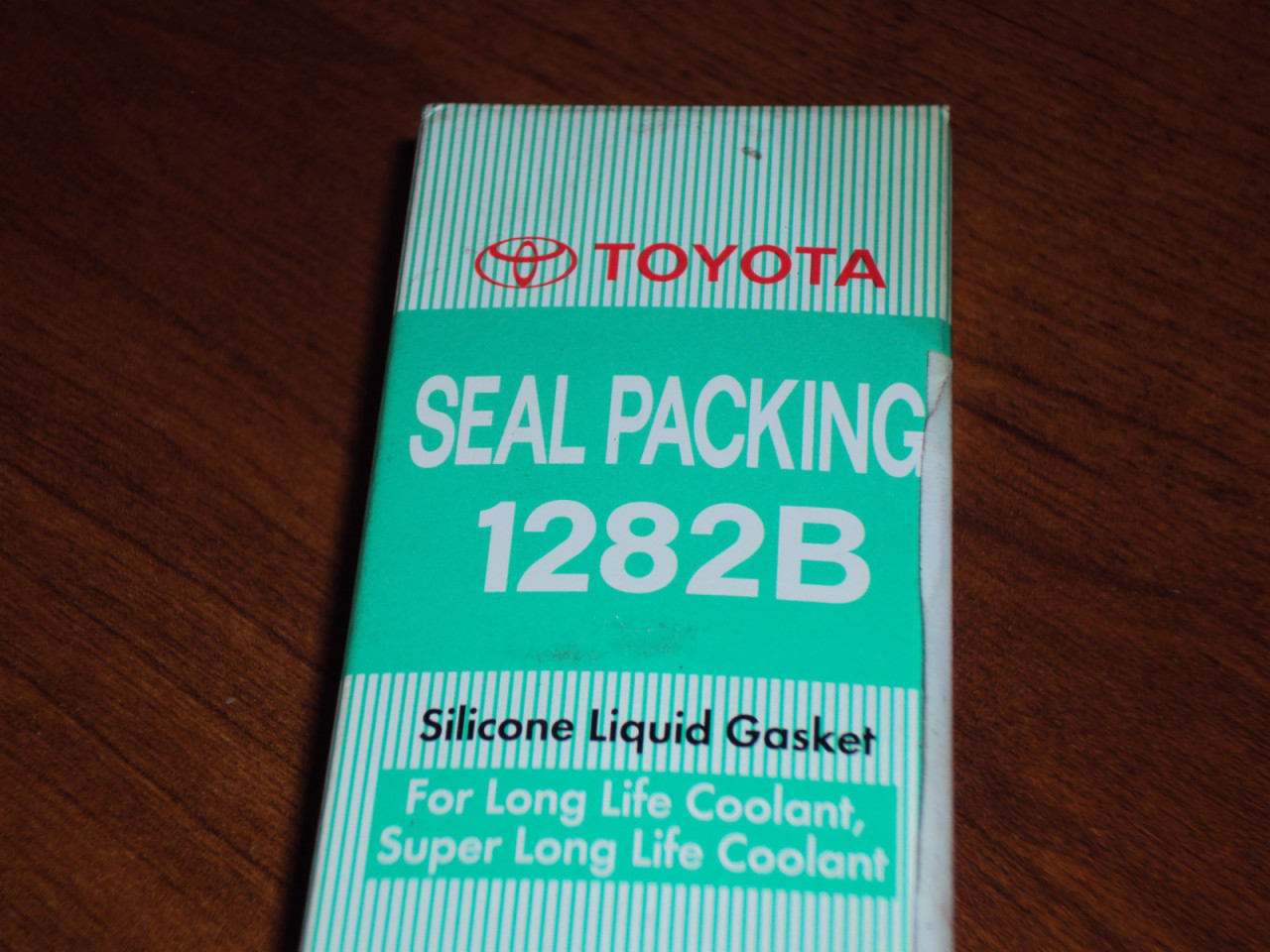

Toyota Seal Packing Black 1282B or Threebond 1282B part number 08826-00100
Toyota Seal Packing 1282B(P/N 08826-00100)

What I would like from you, but have absolutely no expectations of getting, is how you're able to substantiate the claim of it being "Coolant safe FIPG". Maybe that's something you can get a picture of(though I VERY highly doubt it). But if I'm to believe it because you say it's so, you can forget that idea altogether.
