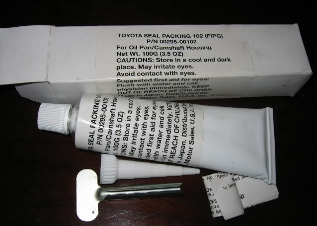

I looked up all of the Toyota interchange part #s on the Permatex® ULTRA GREY® packaging and found one(of the 6) listed that was, in fact, sold as Toyota P/N 00295-00102 SEAL PACKING 102 (FIPG) until it was superseded by Toyota P/N 00295-00103 SEAL PACKING BLACK 102 (FIPG) and/or SEAL PACKING BLACK 103 (FIPG). And one other once sold as Toyota P/N 00295-01282 SEAL PACKING TRANSMISSION-3 (FIPG), until discontinued. Loctite® 5699™ Grey, Silicone Solutions SS-5699 Gray, MaxPro™ GREY OX™, and VERSACHEM® MEGA GREY all state they are interchangeable with Toyota P/N 00295-00102. THREE BOND 1215 is the other grey RTV that is interchangeable with most other brands of grey colored RTVs(used to also be a grey THREE BOND 1217G). But Permatex® Ultra Black® is also said to be interchangeable with Toyota P/Ns 00295-00102, 00295-01282, 00295-01281, 00001-01008(among others). Both Loctite® 5920™ Copper and Permatex® Ultra Copper® are also interchangeable with Toyota P/N 00001-01008.

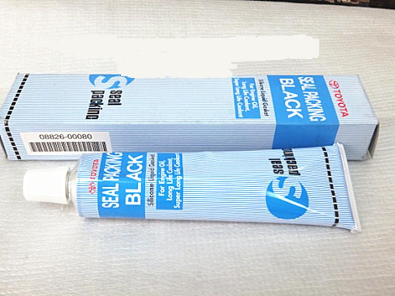

Toyota P/N 08826-00080 SEAL PACKING BLACK 1280 (FIPG), or THREE BOND 1280

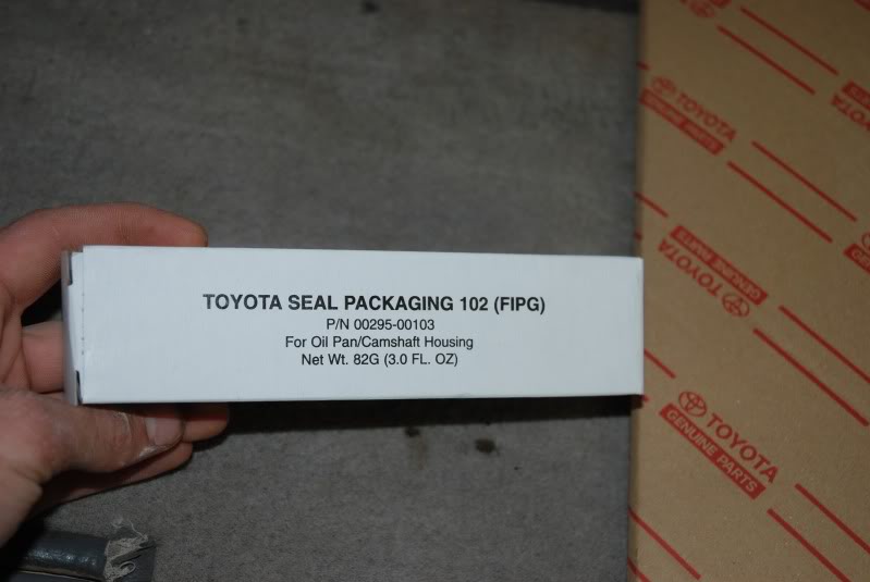

Both were superseded by Toyota P/N 00295-00103 SEAL PACKAGING 102 (FIPG)

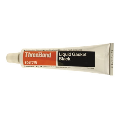

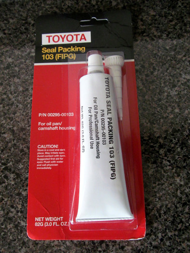

And Toyota P/N 00295-00103 SEAL PACKING 103 (FIPG), or THREE BOND 1207B
THREE BOND 1207B

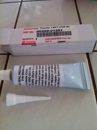

Toyota P/N 00295-01281 SEAL PACKING 1281 (FIPG), or THREE BOND 1281
THREE BOND 1281

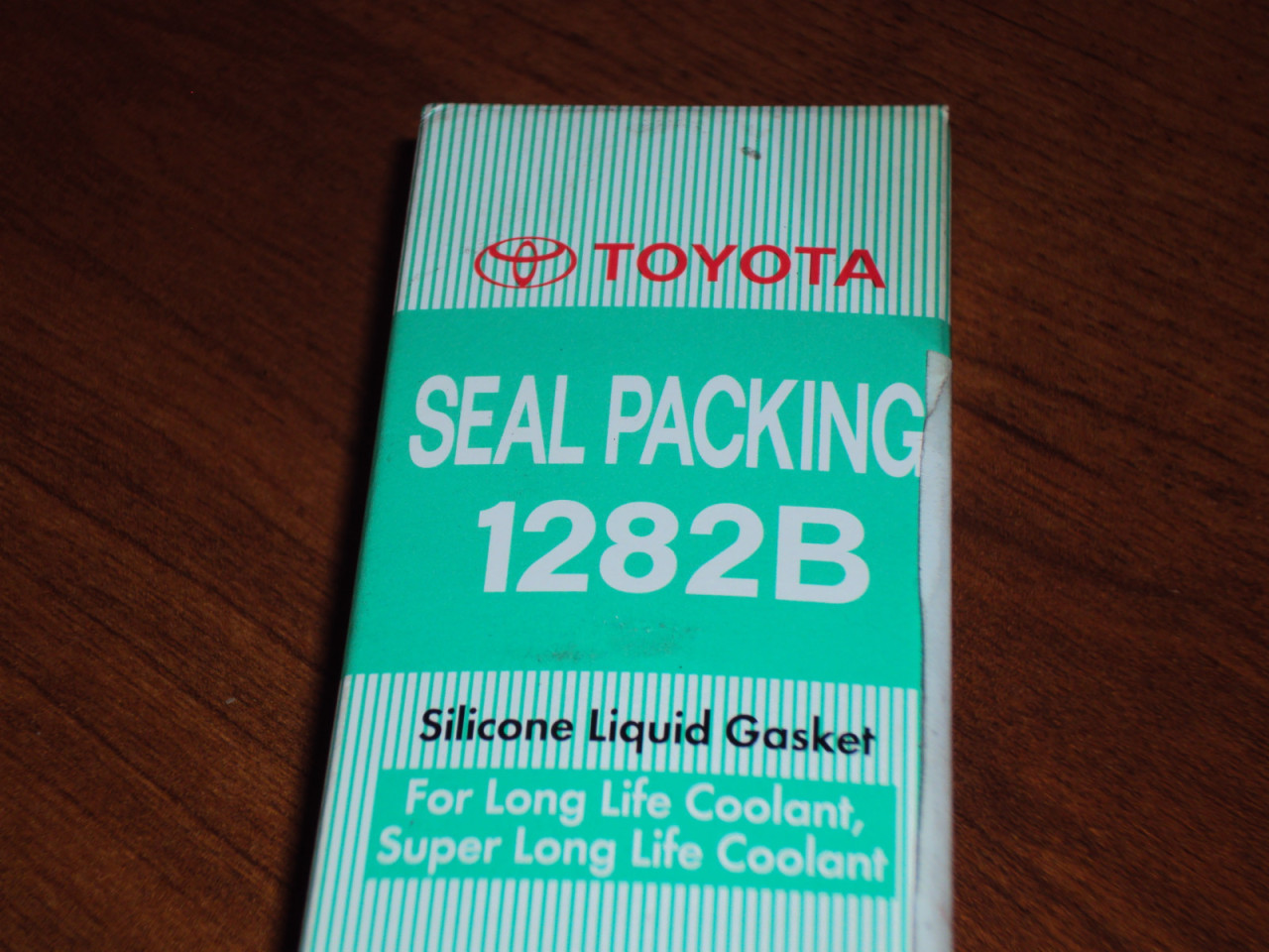

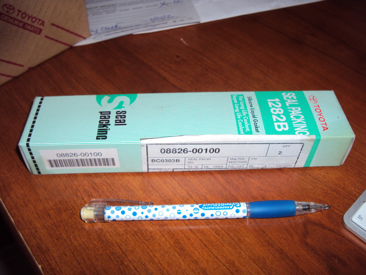

Toyota P/N 08826-00100 SEAL PACKING 1282B (FIPG), or THREE BOND 1282B
Threebond 1282B
