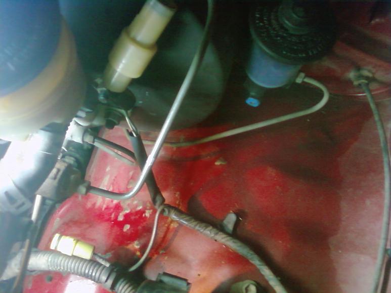

Here is where it is physically. Not sure if it helps but this is where the O2 sensor is on my 87 runner. it is the empty yellowish connector under the master cylinder.
If it is an 87 it should be fuel injected, and have an o2 sensor. The truck will run just fine without it as long as the air/fuel is okay. But if the mix gets off and there is no O2, the ECM will be unable to pick up on it
Hope this helps.

so the wire comes out of the same wiring that goes to the master cylinder, i cannot see any traces of any other wiring other than the two wires that are for the low brake fluid switch?? Definetly no connector like shown in your pic. By the way, my truck is a 88' but that shouldnt matter should it??
