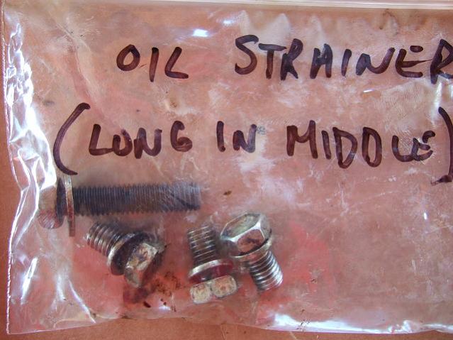

Old Oct 9, 2009 | 04:12 PM
flyingbrass's Avatar
Joined: May 2009
Posts: 586
From: Arizona
The other 3 bolts are all the same size. Here's a picture.
Old Oct 9, 2009 | 05:49 PM
YFZsandrider's Avatar
Joined: Aug 2009
Posts: 219
From: Tacoma, Wa
NICE! Thanks.
