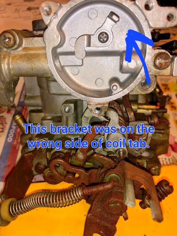

I think I'm on the track and probably have it where I can at least crank and drive it now.

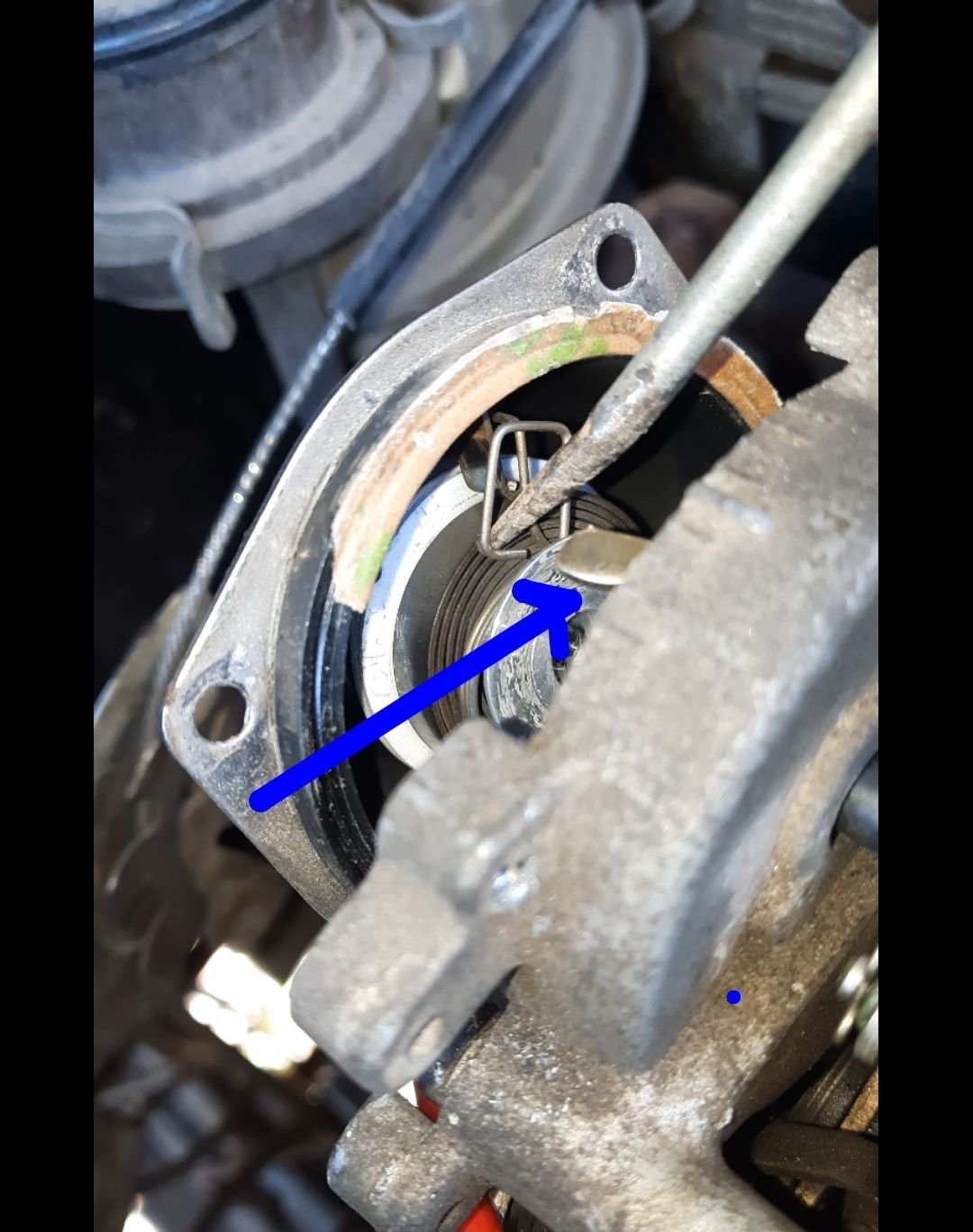

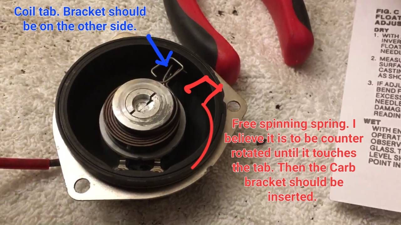

I took two of the electric screws out so I could lean it back and inspect the coil and spring inside. I noticed the bracket on the Carb side was on the Passenger side of the coil tab. I moved it to the other side. The choke butterfly immediately went towards the closed position and closed all the way. I assume this got out of place when the Carb was jumbling around to clean it. I could probably clean it again with out this happening but I guess you learn new things everyday.
I did not know what to do with the other spring in the Choke. Which I think is causing my new issue. Now the choke butterfly is closes all the way when I press the gas pedal. Obviously it doesn't want to crank closed all the way. However, if I press the gas pedal or hold the throttle, the butterfly sits perfectly at about 1/8 inch open. So I can do this to crank it and then it stays 1/8 open. It then slowly opens and then the idle drops. Butterfly is fully open when warm if I let the truck get cold and press the gas pedal the butterfly will simply close all the way, as previously stated. I think that little spring is out of place and I think I know what to do to fix it. Will report back if it works. Sorry if this is worded not the best or I repeat myself, I am typing in a hurry.
I have not completed the Red Part of Picture 2 and I believe that may be my last issue. The Spring is just in there doing nothing. I will take it back off tomorrow and really hope this fixes it. I will report back.
I need to do the red part and see if that fixes the butterfly from just completely closing. I will report back. When i put it back together it was 180 degrees away from the tab.

Ok. I think I have solved the Choke issue. It did get messed up when taking the top of the Carb off to clean it. It now sits at ⅛-¼ inch when I pull the throttle/press gas pedal when cold. It will no longer fall open. I can also can not push it completely closed by hand.
I got lucky and my choke had already been changed to little torx screws. Your's may be rivets.

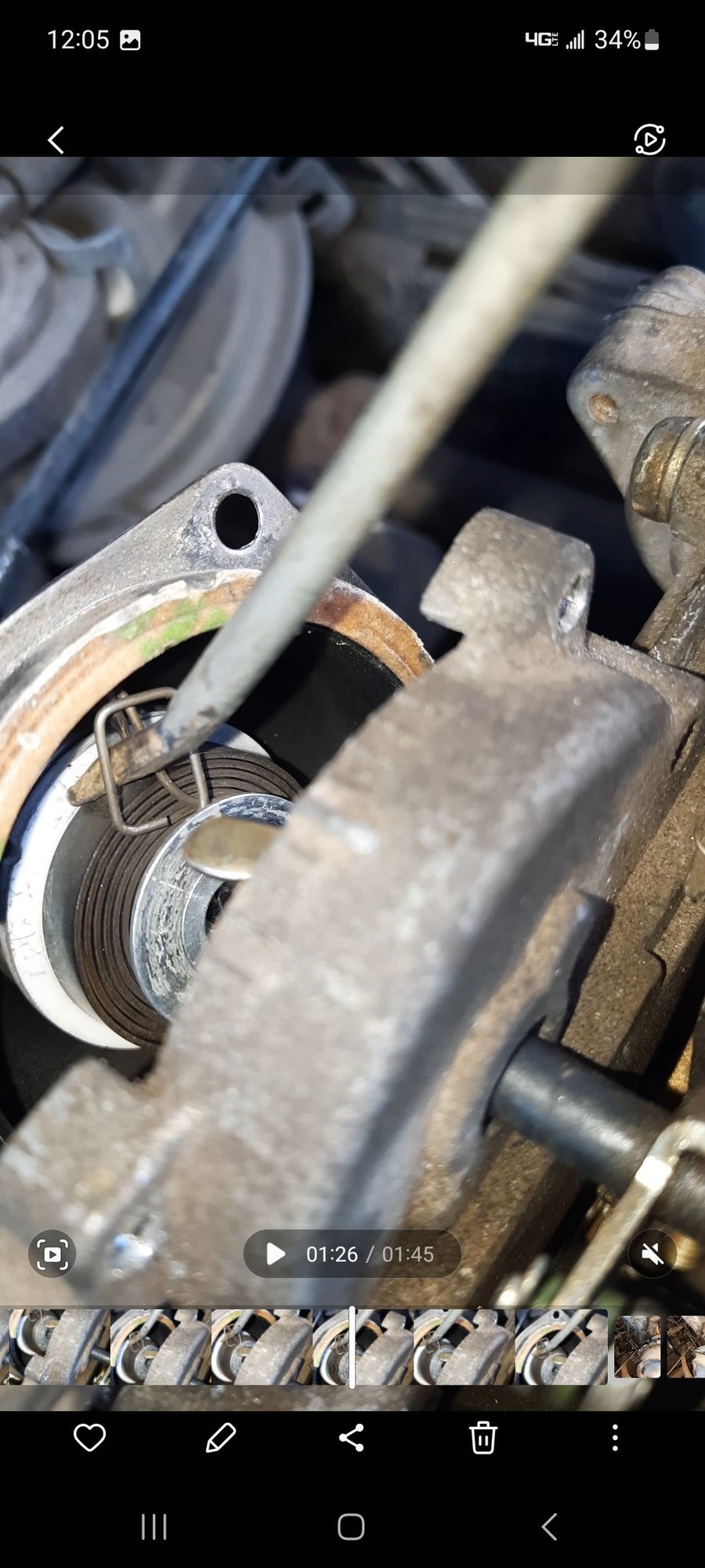

I took the top screws out and loosened the bottom sceew. This allowed me the ability to lean the Choke back. The bottom screw sort of acts like a third hand. I then took a pick and rotated the free moving spring counter clockwise all the way until it hit the coil tab. You will see what I mean, if you ever need to do this. The Carb bracket (blue arrow) does NOT go on the driver side of the coil tab as previously thought. The spring does the part to pull the coil. The Carb bracket goes into the spring "hole" on the Passenger side of the coil tab. It goes where my pick is in the picture. I slowly slid the pick out and the bracket in, as I pulled the choke towards the Carb. It is not that difficult. In my readings I came across a guy from years ago who could never figure this out. They just bought another Carb. Hopefully this post will help somebody out. So far the truck is idling correctly, etc. (Now I've just got my other issues to worry about fixing)
I actually did take a video of this but I think the picture and description show it fine. The bracket with the blue arrow goes where the pick is in the spring hole. Make sure the bracket is on the passenger side of the coil tab.

Better picture. Bracket goes where the pick is. Spring completely counter clock wise. The 1st picture shows the bracket in place. That's as fas as it can be opened while in place, or the spring will pop off.
