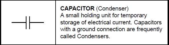

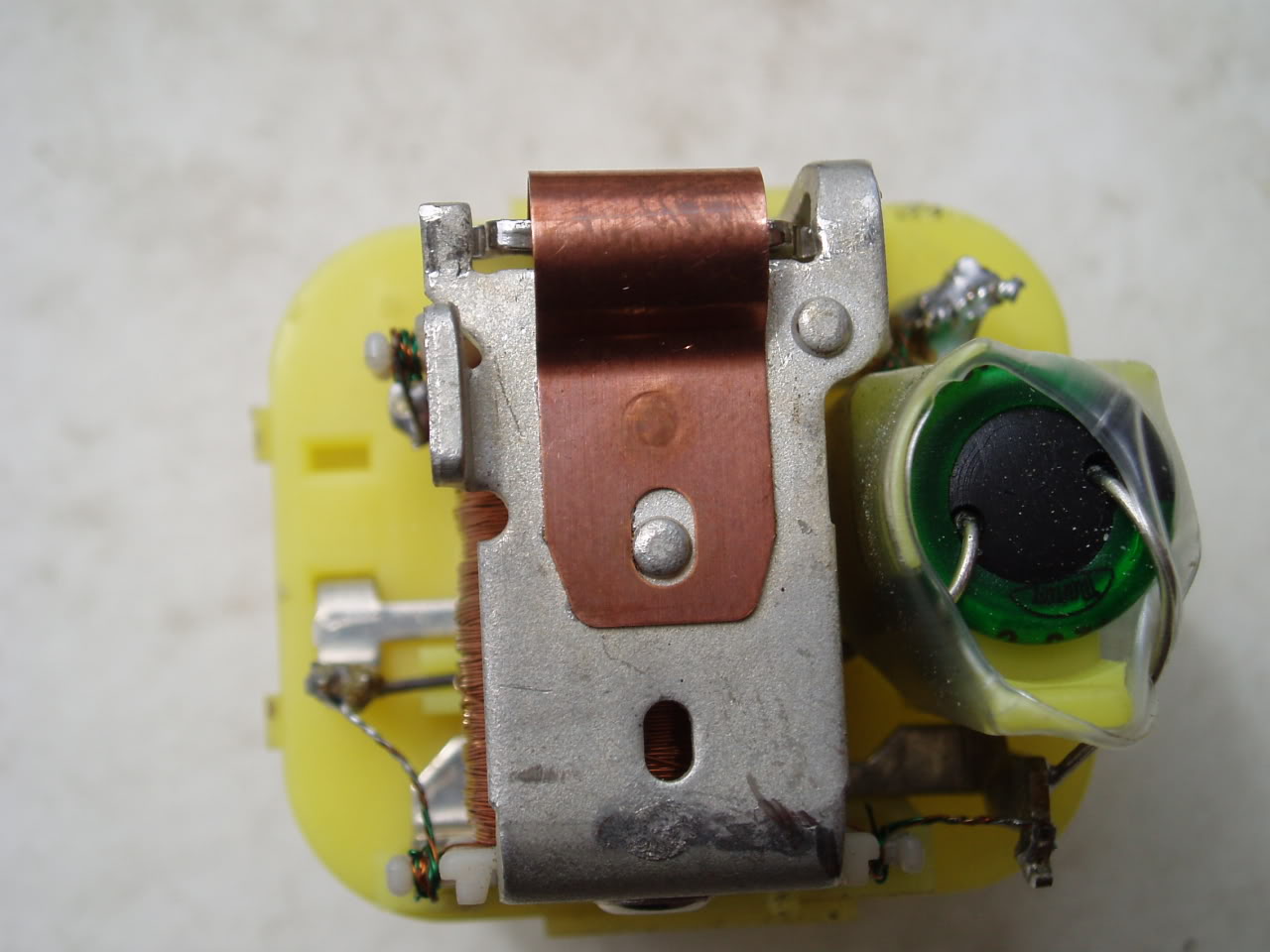

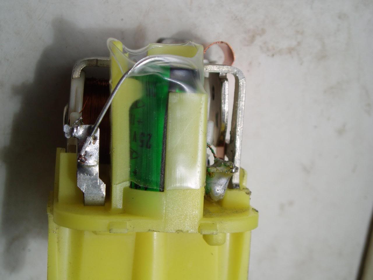

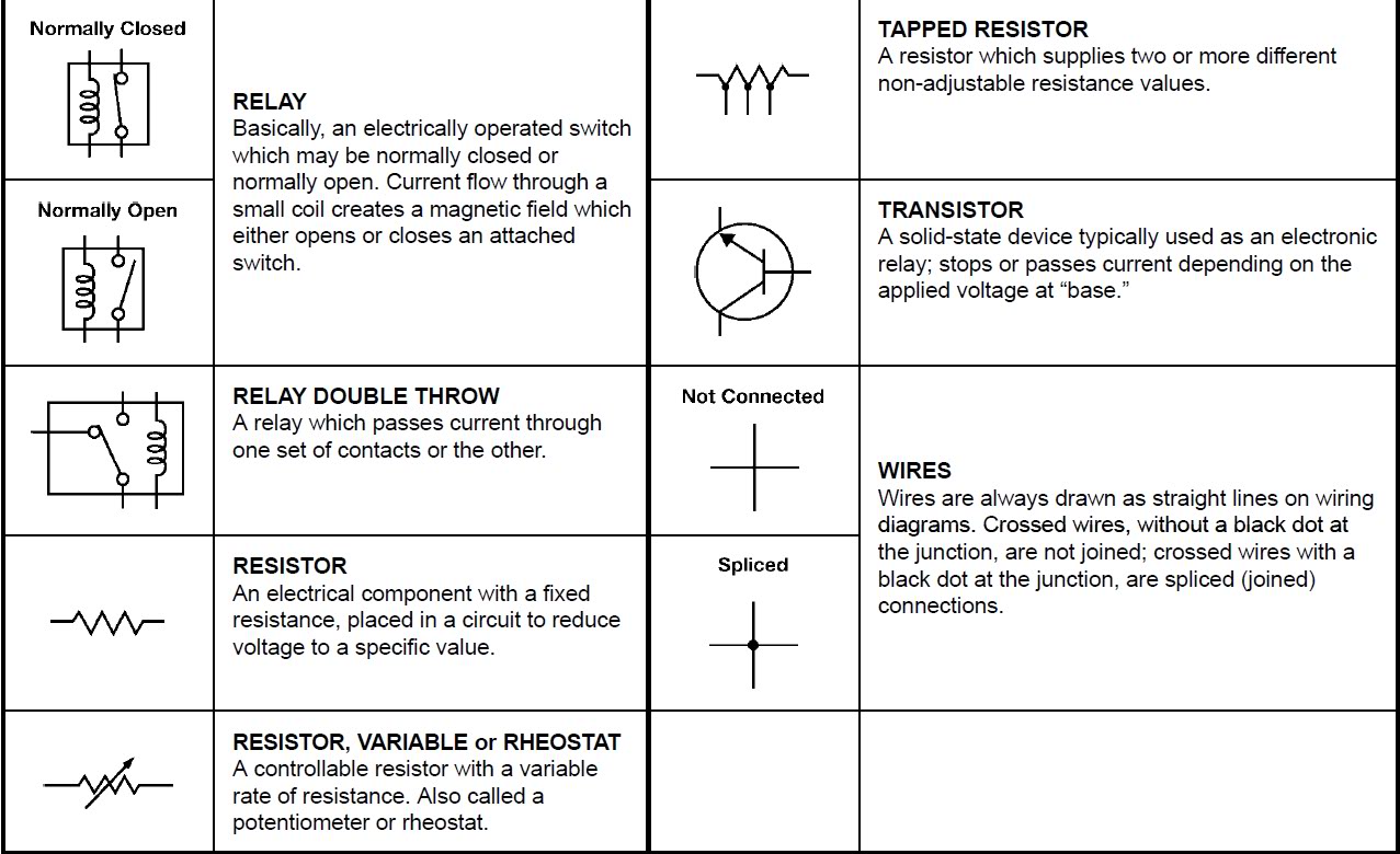

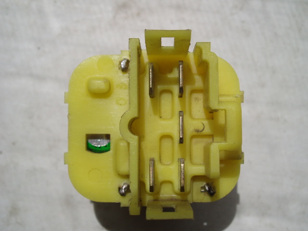

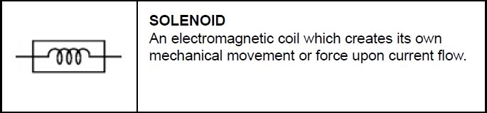

Originally Posted by jbtvt
Cheap fixes for your circuit opening relay - overview, new capacitor install, refurbing contacts, swapping in a higher uF capacitor to prevent AFM signal loss, etc. Hate reading threads about people spending $$$ for new ones...
http://www.youtube.com/watch?v=V8l9QvLAajA
https://www.yotatech.com/forums/f131...od-cor-252680/

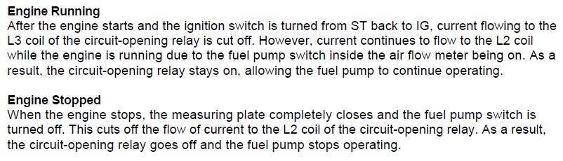

The main point of having the capacitor is to keep the Fp circuit closed if the VAFM measuring plate were to momentarily close/open the Fc circuit while the engine were running. Such as might happen when the engine is idling while the vehicle is travelling over a rough/steeply declined surface. Where the low rpm wouldn't be holding the VAFM measuring plate very far open to begin with(or when the measuring plate slams shut due to the intake air volume suddenly dropping). But it works just as well to keep the Fp circuit closed in such a manner while the engine is cranking/not yet running. Since, even while the engine is just cranking/not yet running, the VAFM is required to keep the Fc circuit held closed while the measuring plate is in any position OTHER THAN FULLY CLOSED!!! FSM specifications dictate precisely that. Not to mention the fact that some models have no STA circuit in the COR. With that type of COR the fuel pump CAN'T be switched on INITIALLY by the action of the starter/STA circuit, but instead the closing of the Fp circuit MUST be INITIATED by the action of the starter turning the engine over, thereby drawing air through the AFM and closing the Fc circuit(hence they NEED the capacitor in the Fp circuit during starting on these models).
Watch the vid, explains it all.
Pages 8 & 9 from this pdf also explain it as described above.
