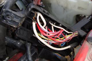

Searched for some answers to my son's '90 4runner issue. No Power to anything!
Seems he pulled into his driveway after being out and about. Went to roll up his driver's side window and when it reached the top of the track is does bog down. when it did, he heard what sounded like rumbling coming from the engine compartment and noticed his AMP meter started spiking in the 18 VDC direction repeatedly. He thought nothing of it and went inside.
The next day he got up to go somewhere and when he turned the key ... NOTHING, no lights no dash gauges no warning buzzer ... zilch! Call Dad

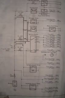

Investigation lead me to believe we must have a blown fuse somewhere, so I got out my FSM for the 1990 4runner (*
another story of a rescue from the bone yard) and looked up the power diagram.
As you can see from the diagram, I checked all the main fuses, the 30 and 40 amps the 80 amp was also checked and found to be good. The only thing common to all of these left the Main Fuse which is supposed to be right after the battery. Not fully understanding what they called the "Main" fuse in the FSM is actually the fusible link. I checked the location in the FSM which said it was located right next to the main fuse panel.
After some searching here on Yota Tech, I discovered that the Main fuse is actually called a fusible link.
Now knowing what I was supposed to be looking for I tried again but still did not fully understand what it was supposed to look like. My previous experience with fusible links was many years ago and it was like a regular fuse but was a small bar in a holder. Well I could not find it anywhere. After a quick search query on Yota Tech

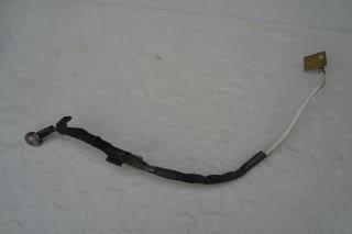

, I found out it was a wire that ran from the main fuse panel to the positive lead of the battery connector.
When I started checking the connections, I discovered that the fusible link had been vaporized! I had a connection on the positive side of the battery terminal but it was only about 2 inches long. There was also another wire that came from under the main fuse panel in the front that had some rather interesting looking insulation. This had been my fusible link.
Armed with the knowledge of what the freaking thing looked like
I went in search of the next replacement part at my local bone Yard and as luck favors the fortunate, I located two 90's vintage 4runners and acquired a replacement fusible link. Very easy to remove intact provided the previous yank-a-part artist didn't just cut wires from the battery or the fuse box.
I can not stress this point enough, you MUST use the designed fusible link for your 4runner. If you use other then designed fusible link, you can start a fire. These are not just pieces of insulated wire, they are specifically designed to MELT at a predetermined current loading. They are also covered in a special type of insulation designed to work with these wires. They help to contain the melting wire without igniting from the heat generated from the melting of this designed wire. If you use normal wiring of the same gauge (which is smaller the the connecting wire on either end of the fusible link) an overload will cause the wire to melt but at a temperature higher then the fusible link which can result in damage to the components of our trucks as well as the high probability of an engine fire. DO NOT cut corners on this wire. It is the same thing as replacing one of the normal fuses in our fuse panels with a higher rated fuse, you will fry something and in this case is could very well be your truck!

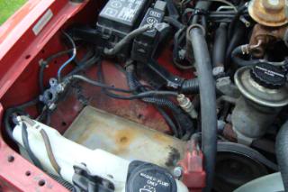

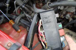

First item to do is to remove the battery.

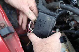

If you have not previously done so, remove the fuse panel cover. Then remove two 10 mm screws securing the fuse panel to the right fender well.
Pull the fuse panel free of the fender. The forward mount also has a small locating tab so be gentle when you try to pull it free.
You will note two small clips on the front base of the fuse panel. These are the lockdowns for the lower cover. Using a small flat blade screw driver, gently lift these up while at the same time moving the bottom cover downward. Once both clips have been removed the bottom cover will be free from the front side. The rear of the cover is hooked over the bottom latch at the rear of the panel
Swing the cover clear and unlatch it from the back location. This may be difficult due to the wire bundles near the rear of the fuse panel.
Remove the bottom cover exposing the underside of the panel.

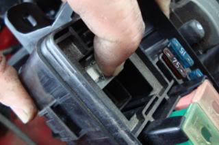

Removal of the fusible link wire from the 80 amp fuse requires removal of the fuse. This fuse is held in place by a locking block. near the rear of the mounting location you will note what looks like a clip.
Push the clip towards the edge of the panel while pushing the 80 amp fuse downward.
Fully pull the assembly from the bottom of the panel.
One side will have two small phillips/hex screws. This is the pair of screws that hold the fusible link to the fuse and are 8 mm. I recommend using either a wrench or socket to loosen and removal of those screws. If you are only replacing the fusible link then skip the next step as removal of the single 10 mm screw is not necessary.
If you are going to replace the 80 amp fuse then remove the single 10 mm screw on the opposite side in the same fashion.
The fusible link is now removable from the system. Attach the new fusible link in the correct location on the fuse with the other two red wires using the 8mm screws removed previously.
If you replaced the 80 amp fuse, finish up the replacement by installing the other white wires on the opposite side and secure. Insert the assembly into the same location from the bottom of the fuse panel.
Continue pushing from the bottom until it is fully seated. You should hear a slight audible 'click'.
Position the fusible link wire under the panel towards the front cutout. Fit it into the cutout and then attach the bottom cover and snap into place. This will secure the fusible link in the panel.
Remount the fuse panel with the two 10 mm screws, attach the loop end of the fusible link to the POSITIVE (+) terminal battery cable and secure it firmly to the connector.
Reinstall the battery ensuring that the NEGATIVE (-) terminal post is closest to the right side fender, the POSITIVE (+) terminal post is towards the engine. Connect the negative terminal first and hand tighten. Attach the positive terminal and hand tighten. You have now completed your fusible link installation.
