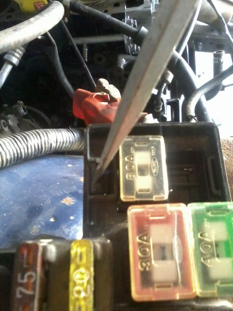

Here is another view of getting the 80 Amp fuse out.
All of the other fuses lift up and out. The 80 Amp you have to pry this tab to the firewall and push out the bottom.

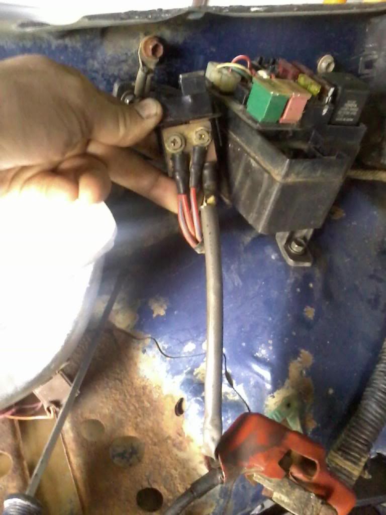

Here it is mounted to the Fuse. It mounts behind the wires. I usually have to take a 8mm socket to the screws the first time. They can be TIGHT.
