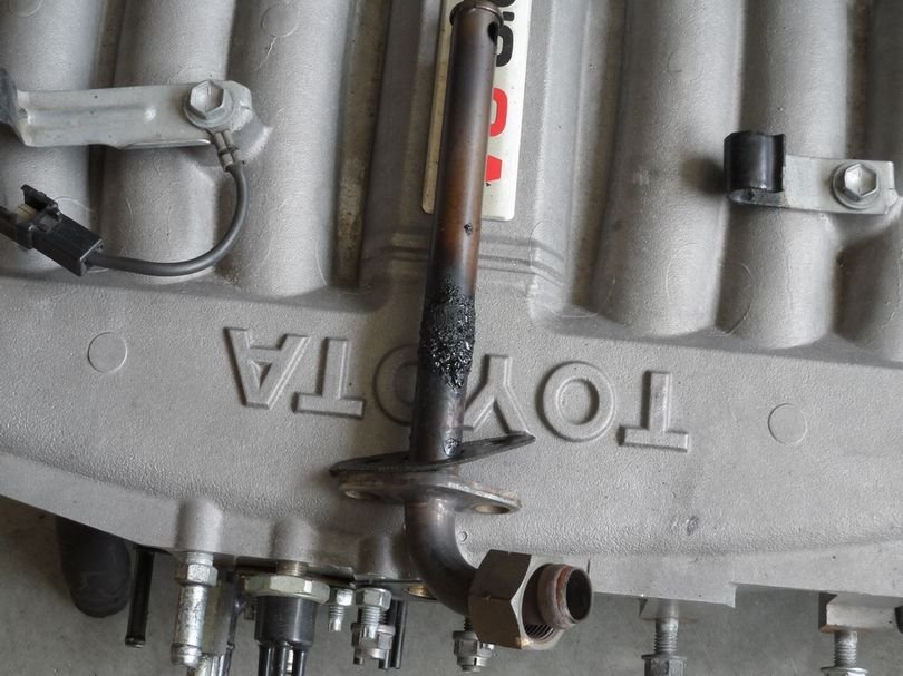

The 3.0 is heavily reliant on the EGR for keeping cylinder temps down (NOX). Anyone removing it is not doing their engine any good. I don't remove smog equipment and in fact go to great lengths to assure it is all working correctly. Not a lot of blow-by in a motor with 20000 miles on it. I could pull the plenum and show what the EGR puts in the engine. In fact there was a tread on here at one time showing a plenum from an engine with the EGR removed Vs one with a EGR and you would be amazed at how much sludge the EGR puts in the engine. Best thing is to run a fuel cleaner about every fourth tank of gas to keep deposits down and HP up. Need every bit of HP you can get in a 3.0.
Your pick shows you may have an issue with your rings and a faulty EGR. That EGR tube is rarely that clean. Is that from a new engine?

The EGR tube had been "recently" cleaned; this is a few months (a year?) of buildup. You can't see it in the photo, but the PCV tube makes a turn inside the plenum, so it "points" right to the spot on the tube where you see the crud.
Even several months earlier when I removed years of buildup, the crud was concentrated on middle of the tube (under the PCV circuit), and the end of the tube where the exhaust gases are introduced was relatively clean. So I don't believe the exhaust gases contribute a significant amount of solids.
But as to your issue, I too had so much crud inside the plenum that the idle-ups were not working. I cleaned it with solvent and degreaser in a mortar tub with bottle brushes. I did not remove the "freeze plugs" in the ends. In retrospect, I should have.
