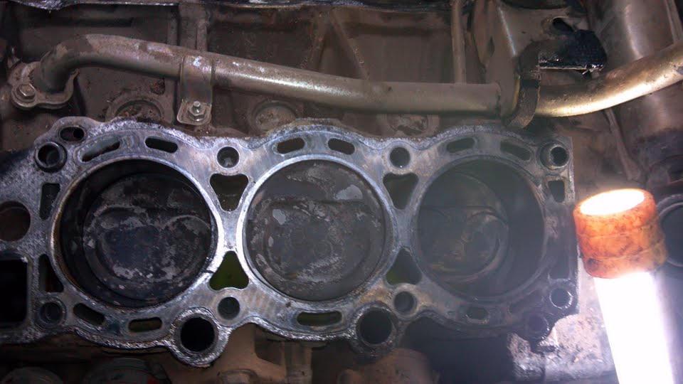

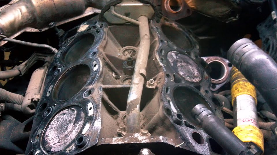

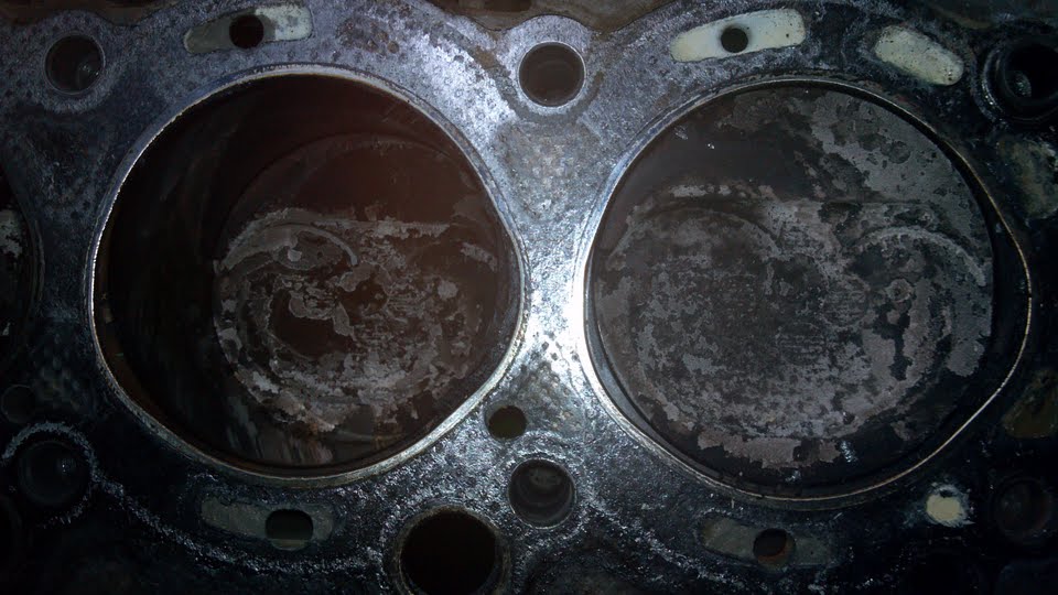

Ya I'm hoping my heads are ok and can be milled, and I am also hoping that these pictures aren't going to pose a problem to my plan of putting this thing back together. I'm not sure how a piston is supposed to look after its been put through a 178,000 miles of work.
I've read how its bad to clean the pistons still in the block because stuff can get stuck in the cylinder. Does this look normal forsome used pistons?

1. I wouldn't buy the knock sensor; they're very rugged and not much can go wrong with them. The problem is that there is no simple way to test them. If you're willing to take my opinion on faith, you'll save $200. (Or you'll put it back together and throw a code. ...) DO get the pigtail; yours is toast and they're not expensive.
2. Avoid "eBay junk," but go ahead and get the good stuff. Just be smart in your purchases. If it seems like a helluva deal, it's probably not what you want. But you can get very good prices on perfectly good items on eBay.
3. I had my machine shop get the head gasket kit for me. They need the valve stem seals out of the kit, they got a better price than I was seeing, and I've been happy with the results.
4. You need to get some progress at the machine shop no matter what you do. They need to pressure test the heads, and if one is cracked your whole job will be much iffier. So as others have said, get going with that first.
5. Dirt is dirt; don't worry too much about what the pistons look like. You have to clean them (carbon can cause pre-ignition), and removing the pistons is a relatively big-deal. I recommend a shop vac to pick up the dirt if you can swing it, and just clean them in-place.
The key to whether to proceed is whether you and your girlfriend like the truck. Is it just so-so? Is it a pain in the ass? Then dump it. But if you like the truck, that means that you're not likely to have something else happen in the next 4 weeks, so $1,000 will almost certainly get you another 60k miles. Or more.

They should be cleaned. Plug the oil holes. Back flush your radiator and change your oil after running for 30 min.

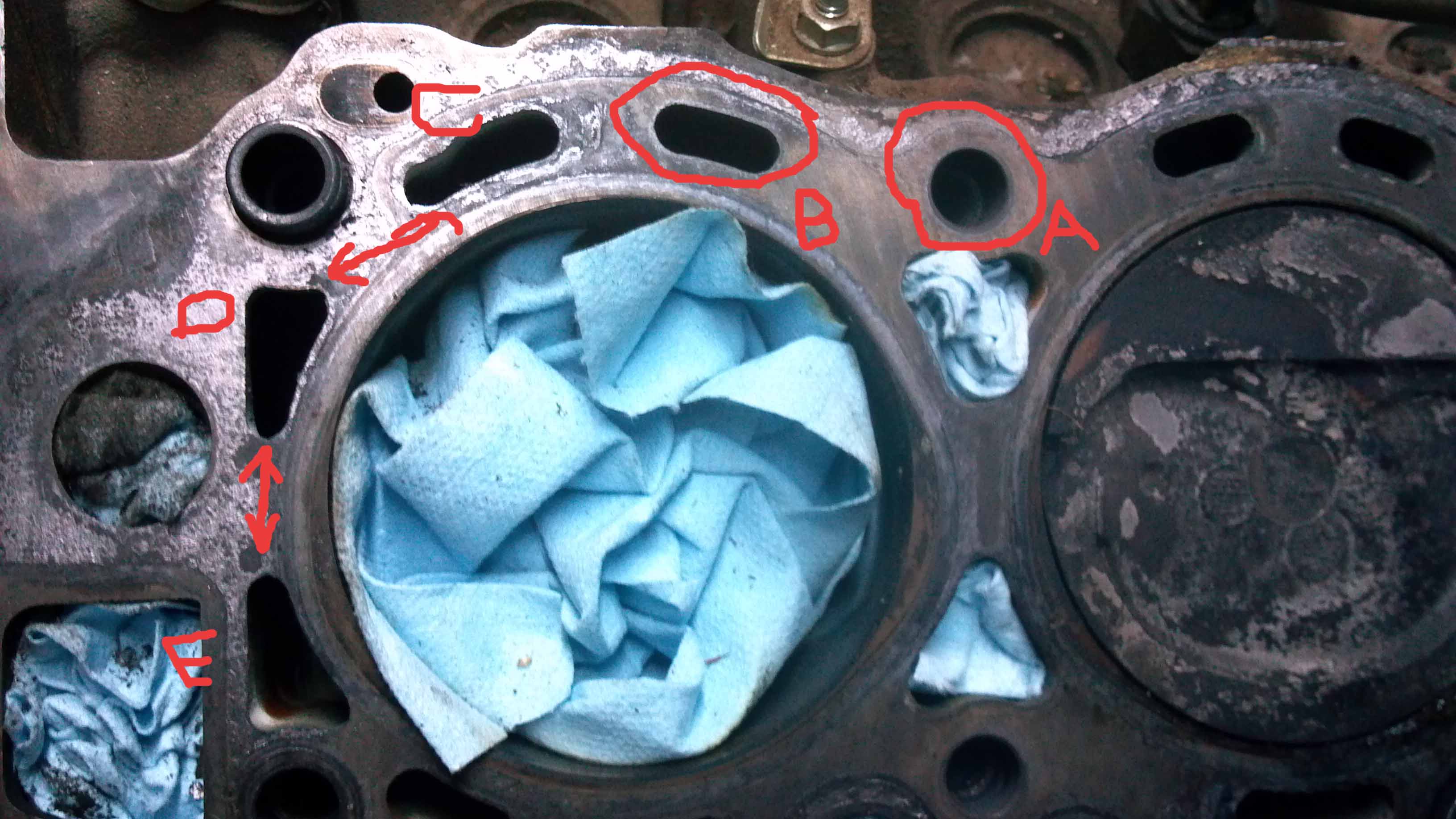

So I just got done with the little work I did today.
I got a nice straight edge from my good friend, and was able to see that the engine block looks fairly straight. There was one little section that was off by .001, but I'm fairly sure that is not a huge issue.
The machine shop is going ahead on my head, so that is a +, and they have a cam from one of there vendors.
So the question I have, after starting to clean the engine block, is how careful do I have to be about the little holes I pointed out in the picture? Are any of those holes sending oil through there?
If they are just coolant, then it wouldn't be hard to not worry and then just flush the coolant out and get that crud out of there.
It sure does take a lot of scraping with a flat razor to get the old gasket off, and I definitely don't want to ruin the whole job from getting crud in any place that it can't go.

^^ send that block to machine shop and have them check it and clean as well!! its better than your current plan in my opinion..... to me putting a shop vac in charge of that baby is just a diaster waiting to happen!

Well 2 days ago I got the engine lift and everything ready to go, and then I did the math and its just not going to be feasible with my finances and time. So...with that being said, I am just being extremely careful not to get anything into the cylinder holes.
But, Rockland, I took all of your advice to heart, and that is when I found that you are right, all of the eBay stuff is pretty much crap (unless you know exactly what you are getting).
