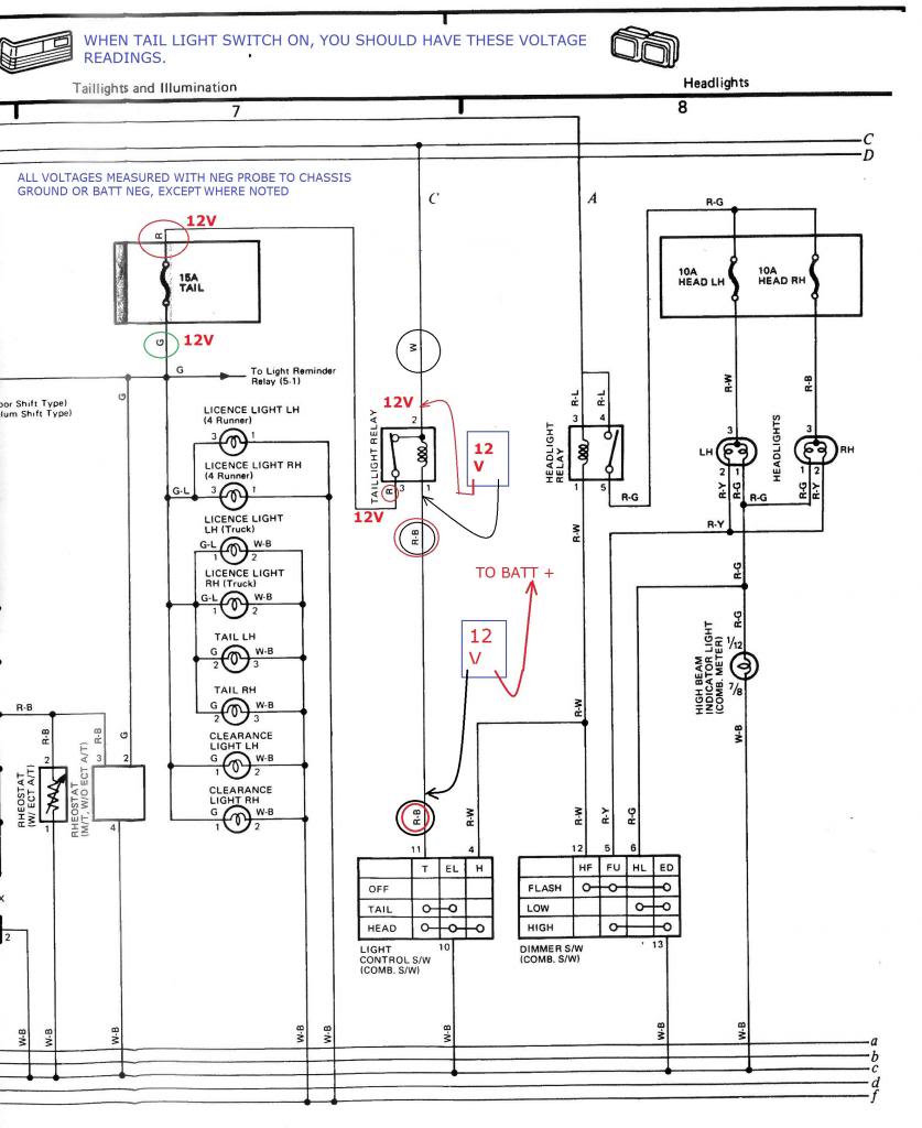

If you have hazards but no HB, then like Terry says^^^ dimmer combo switch contact between pins 5 (where R-Y goes) and 13 (where W-B goes) is bad. (This contact connects the Red-Yellow wire to ground, and R-Y connects negative side of HB filament in order to turn on HB filament.)
Verify this way:
(1) Turn low beams on and verify they light up,
(2) Switch to high beams,
(2) Jump Pin 5 (where R-Y goes) to ground.
One cause of death of dimmer-combo switch is the flawed wiring of the headlight that subjects the dimmer-combo contacts to too much current as shown here.
Clean, robust and simple fix is the H4 conversion harness.
Schematic is here. NOTE: Test point notes are only needed if you do not have any headlights at all.

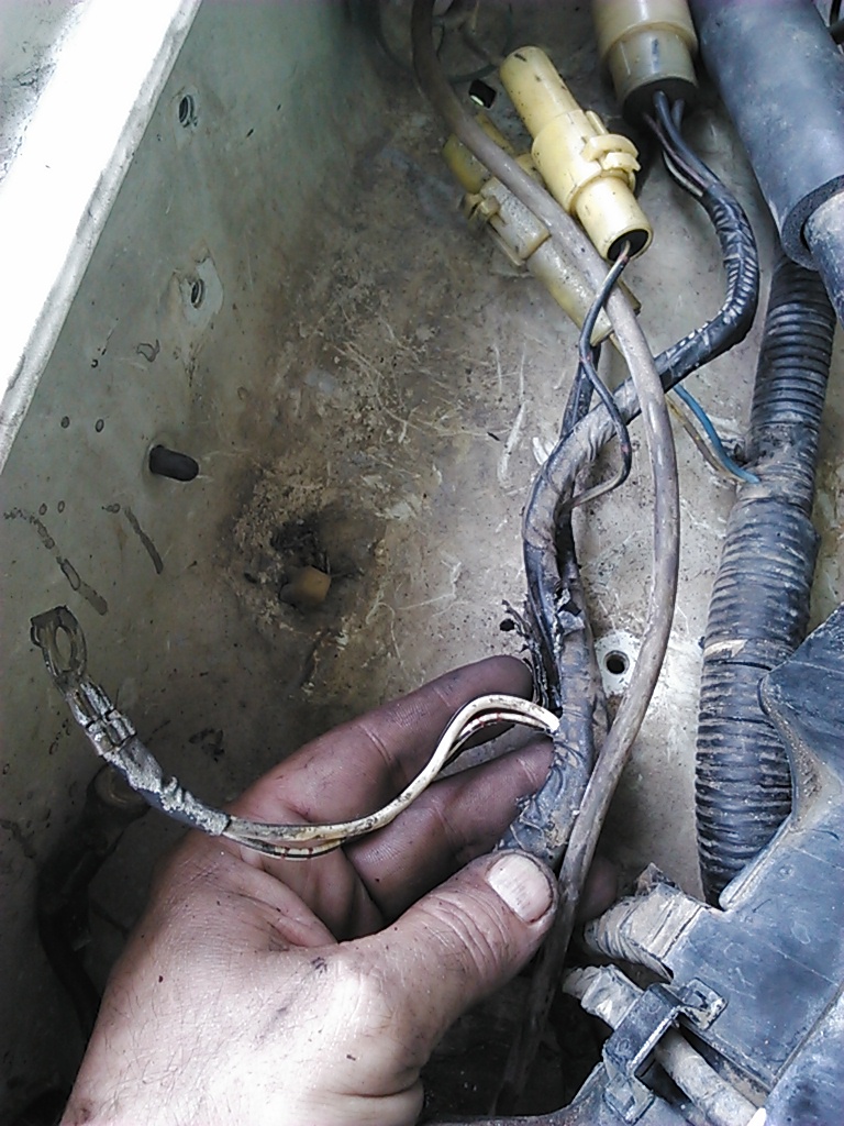

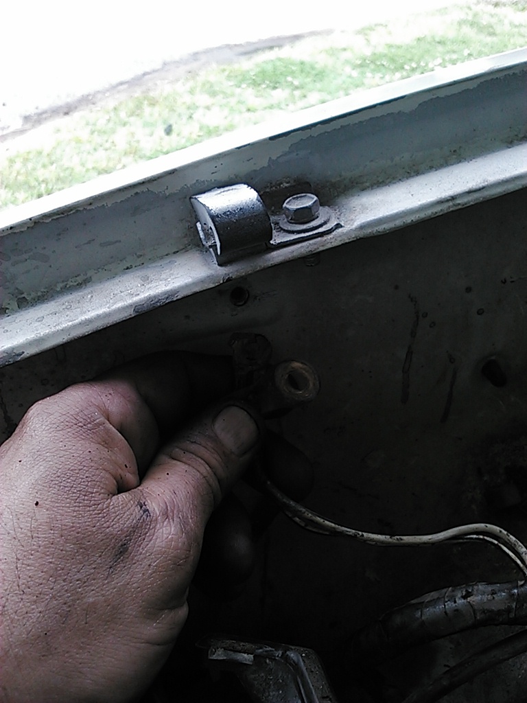

Another little upgrade that I think could help is to move the head light harness ground in direct contact with the battery ground.
Upgrade I got off of RAD.
I moved the headlight ground wire to the same point that the negative battery wire attaches to the body.
The bolt hole above I cleaned down to metal with a wire brush and cleaned the contacts. I did that in the past but just for reference for others. When I find the problem to this I will add it to my 88 Runners first page for trouble shooting and fix list.

You need to open the harness an inch or so to make them connect.
