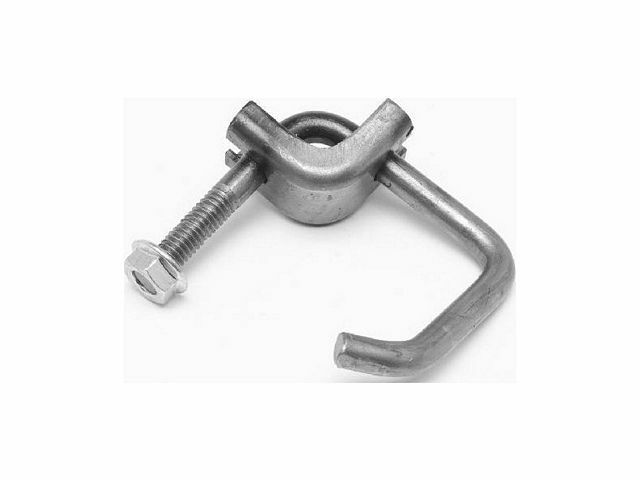

My mechanic advised me that my tailpipe is gone and needs replacement - i think he left it for me to do as it should be fairly easy. Anyways, its a 1990 4Runner 22RE. He handed me one rubber insulator which I believe is from the very back. So I went to RockAuto and they seem to have all the parts except for the main tailpipe. They have the clamp to the muffler (35343) as well some hanger parts that theoretically go at the back (35702 and 35199). All the parts are Walker. Looks like I can get the Walker tailpipe (44450) from elsewhere. A couple questions I have (I have searched the forum and got a little bit of insight but not totally).
  1. Is Walker brand decent and as good as any or should I be considering something else?
  2. Am I correct to assume that those two hanger parts I mentioned above go together on the end of the tailpipe? One is a simple clamp that would go around the tailpipe and the other more expensive piece is a c-shaped bolt that I assume bolts into the simple clamp going around the tailpipe? I did find a picture (evidently from an older vehicle) that showed this sort of arrangement,

On my 86 truck it's one rubber hanger that the tail pipe bracket rod that slips into on one end with a pipe clamp on the other end. Looked up 1990 4Runner on a parts page and looks to be the same design.
I installed a one piece Bosal muffler/tail pipe exhaust. It has the flange to bolt to the Cat Conveter, the 2 hangers rods welded on place behind the muffler. Is does drone a bit at highway speed. It fit perfectly and was only $115 in 2019.
This is what the hanger bracket looks like on 85 to 95 4Runner . The end with the bent down portion slips into the single rubber hanger.
The threaded end slips into the hole in the tail pipe clamp .
