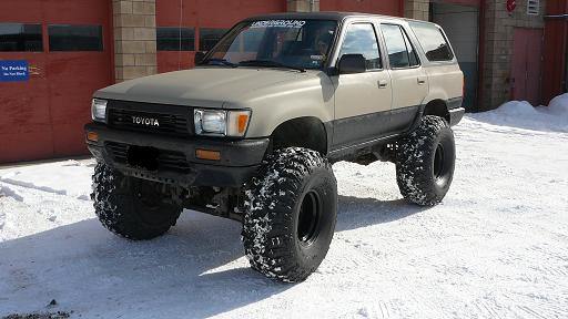

Just painted the 91 runner we just got. Used to be red. I actually have the pics of all the prep to but here is the before and after.

Looks good. Cool way to two tone. Are those colors flat or satin?

man that looks good props on the good work

WOW, looked like a landcruiser at first glance,
then I read your sig! 39.5 irocks on IFS with a 4cyl!
double WOW WOW

Hey thanks for all the postive feedback the colors are flat. I need a to get sas'd bad! This thing is a time bomb. It drives like a cadillac though.

looks great would look better covered with mud

SO I am doing my homework to paint my rig (Moab Camo) And How much sanding did you do. Did you then clean with acetone? How many layers of primer? And Finally how many layers of final paint? I plan to use www.aervoe.com paint. Thoughts?

Yeah we used straight up rattle can paint. The only real prep we did was scuffing the whole truck with a 3M scratch pad and sanded the actual rust spots with 80 grit paper and primed those. Then we used about 6 cans of black for the roof and about 12 or 14 for the tan section in the middle. The bottom black portion is herculiner roll on bedliner 1 gallon for the sides and bumpers. Hope this helps. Thanks for all the positive comments.

i really like it, and looks damn good for rattle can!

Did you put the liner over the new paint or the old? It looks clean too. I like the two tone.

I have seen more than 1 person on here now with the Herculiner Roll-on Bedliner down the side of their truck/4runner. I think I'm going to ddo this when I have my truck redone by my friend.
What did you have to do to do the bumper and grille area?

looks good man. that's what i've got going on too. bedliner-two-tone!!! woot
