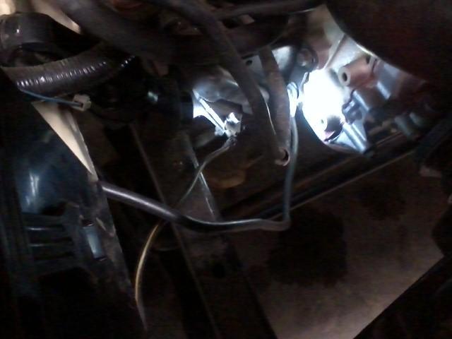

This is on an 85 and is the long cable. I have seen a short cable about 8 inches long but basically has the same purpose. I have the ground that is connected to the battery which is above the rubber in the motor mount.
The other cable is below the rubber in the motor mount and goes to the body. I have seen the newer trucks just have an 8 inch jumper going from the top of the motor mount to the bottom of the motor mount basically jumpering the rubber. Either way would give the same results with a long or short cable.
I think in hind sight and something I am going to do later on is instead of having the long cable coming from the bottom of the motor mount to the body is do the shorter jumper so that is in a more direct contact with the battery ground cable.
