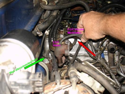

Thanks for the reply and advice. I tried both the lucas and gum out treatments but that did not seem to help. Last night I went ahead and pulled off the EFI to get to the injectors, and got them out this morning. When I took off the EFI/throttlebody, I found a vacum line that was not attached. I could not see it when everything was assembled due to the EFI. It is a line that comes from the EGR Vacum Modulator and was supposed to be hooked to the EGR valve. I have attached a photo. The green arrow shows where the line was unhooked and hanging freely. Could this have been causing my problems?
I am going to try and track down an injector cleaner locally today. More to come....

Mm....yeah....hahaha. The EGR is supposed to open for high flow under high temp's and hard acceleration. With that line being disconnected, there is a vacuum leak at the modulator preventing the opening of the EGR.
Here's a good link...
http://www.autoshop101.com/forms/h61.pdf
Man, if there was ever a reason for anyone to get a smoke test run to rule out vacuum leaks, this would be one. The little things that are hard to track down. Ya hear that, Chef! Get a smoke test run...asap.

Looks like that could certainly cause the sort of problem I am having!!!! I am going to proceed with the injectors though since I have got them out. Dont you think? YOu guys rock!
