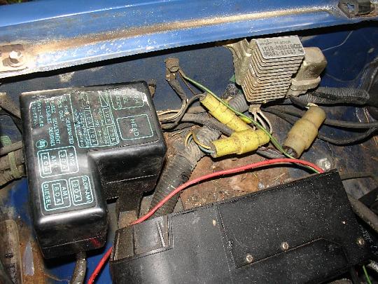

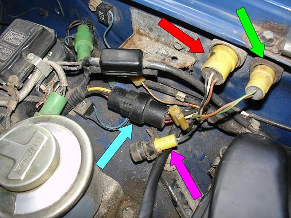

Today I took the truck for a drive an noticed that the problem gets worse the longer the engine runs. It finally got so bad that it would hardly go. Any time I would push on the gas pedal it would want to die. It is almost like a rev limiter...Pulling over and turning off the engine even for 5 minutes would help and i could drive it again for about 5minutes before it would go back to a near death crawl. I got home and replaced the fuel filter. This did not cure the problem. I then went to check the computer read out but I cannot find the check or diagnostic connector (the T-E1 jumper). I have attached 2 photos one shows several arrows...which arrow is the proper connector? The second photo shows where the diagnostic connector should be, but since this is a 86 I am guessing it is a check connector on the drive side (in photo #1)???
Attached Thumbnails Need some good advice on a 22-re problem-photo1.jpg   Need some good advice on a 22-re problem-photo2.jpg
Old Jun 27, 2010 | 02:39 PM
ehertz's Avatar
Joined: May 2010
Posts: 95
From: Nixa Missouri
Not that I know of. You talking about the hose going from the air filter box to the EFI?
