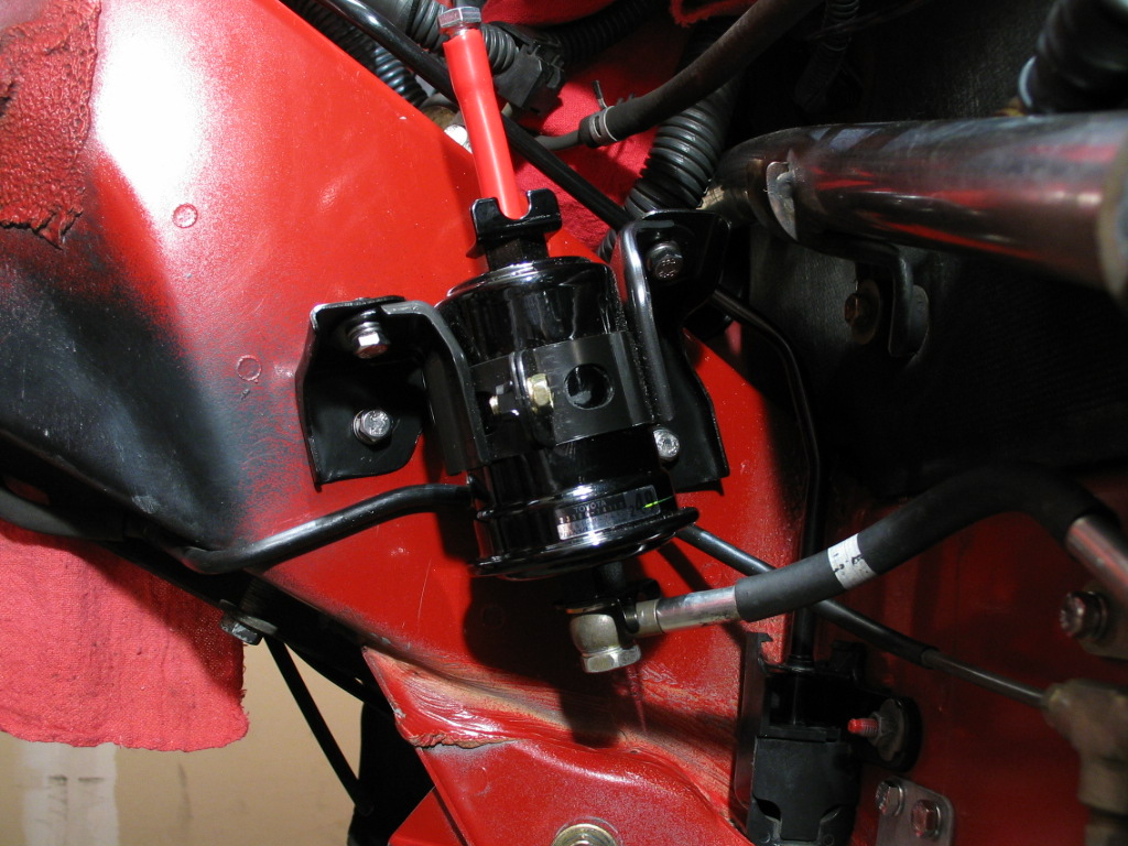

Also, that's not a banjo fitting, that's just a union. This is a banjo fitting on the bottom of this pic. It's a Celica, but you get the point- it's a Toyota fuel filter:
A closer look at a banjo:
(For the record, I just snagged that image from Google.)
