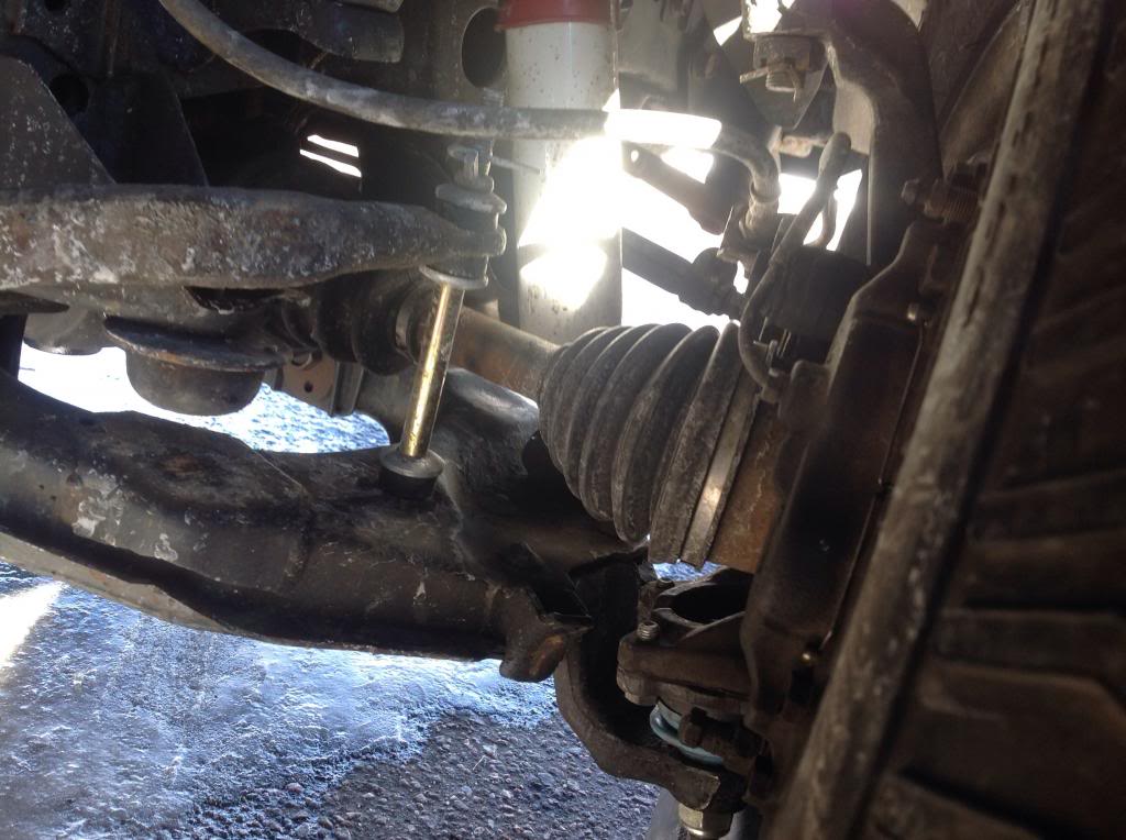

we really need more information from you to give proper input. please get us pics of the rig showing your IFS as best you can, especially pics showing how your steering is setup. use photobucket or similar hosting site post the pics.
first off, just to assign a height to your current lift -- what is your distance between center of f/r axles to the bottom of your fender lips? this will give a better idea of how the geometry of your steering is so we know how tall your rig actually is. stock is somewhere around 20" I think i could be wrong (example: my truck is at 22.5" with a 1.5" bj spacer/tbar crank up front, OME leafs in back)
my assumption is that you have too steep of angles in your steering geometry from too much lift up front (without relocation brackets) and thus the problem has arisen. there is a limit to how tall you can go on IFS before you start needing some of the components included in some of the 4" bracket lifts (items like new cast steering knuckles or steering relocation brackets).

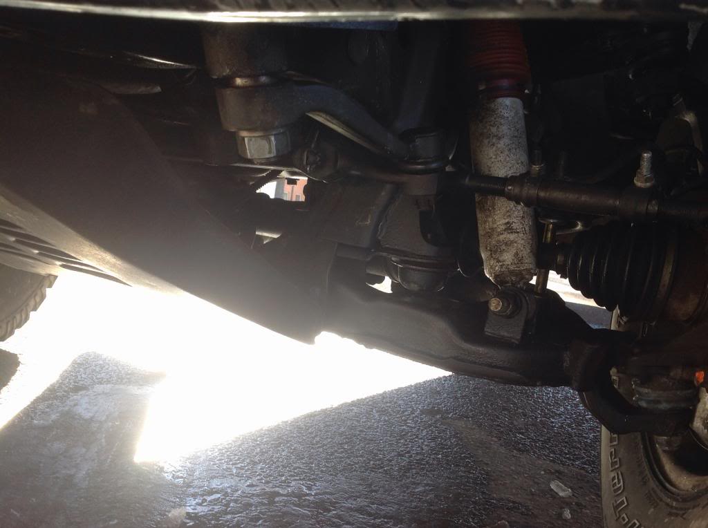

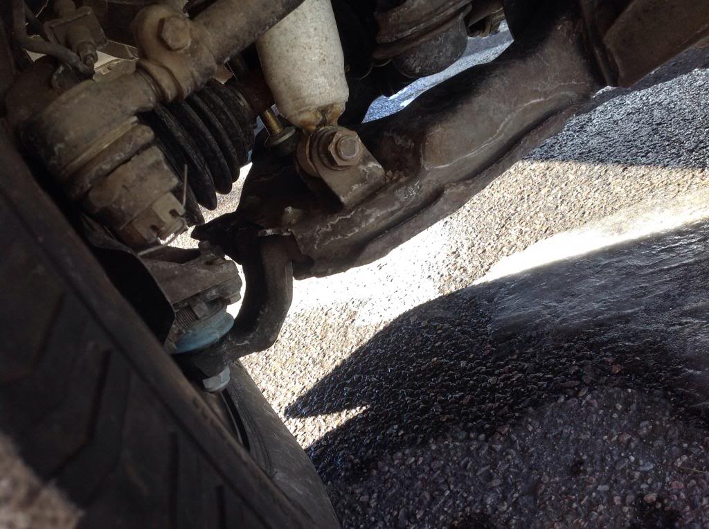

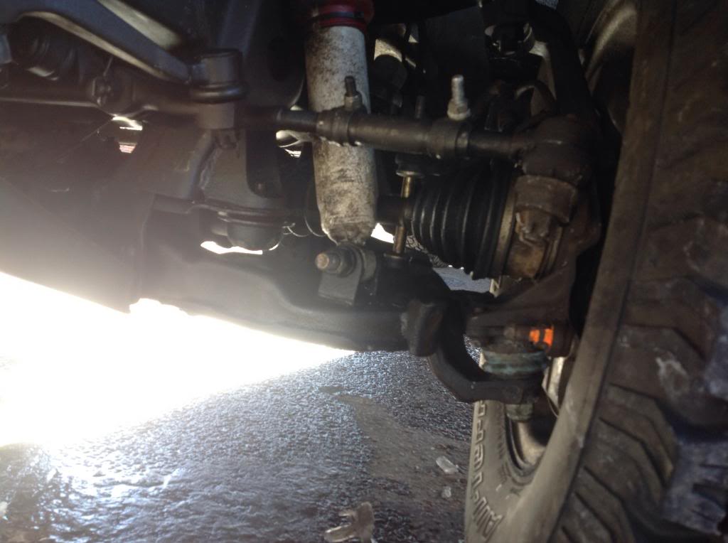

I got pics during lunch this is with the front lowered but it does not matter because it still shakes!!
This is front right from the back

Front right from the front
Front left from the front
[URL=http://s1374.photobucket.com/user/Jakesr5/media/image_zpsa24704c0.jpg.html]Name:  image_zpsa24704c0.jpg
Same

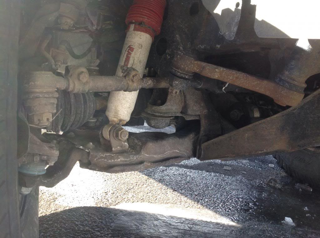

Here is front right from the front but the steering stop on the lower is gone? Don't know what happened there
Might be showing this one again but look at the steering stop bolt. They told me they have no idea why my steering radius was lengthened by 4 feet!! Hhe I can't imagine why??

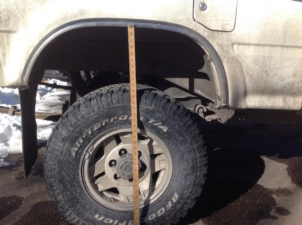

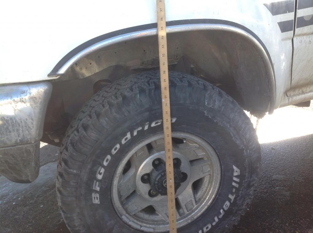

Here is the lift measurements
Rear (passenger but driver is 1/4 inch lower
Front right
And front left

Could be shaking due to worn out steering components. Could be due to lack of alignment after you lowered it.

I see a few things - front height looks good you're only around 20" which is like stock height in front. If you had a pic further back showing both sides if your ifs I'm sure we'll see your cv angles are very low which is good. I don't see your bj spacers, just curious to see what a larger than 1.5" one looks like.
My guess is you first need to eliminate slop from the equation. New suspension components would be good - all movable joints basically, and a fresh bearing repack and alignment. My guess is just there you will see improvement. Remember each time you play with tbars you'll technically need an alignment, which is why Firestone lifetime alignment pays for itself after the 2nd visit.
