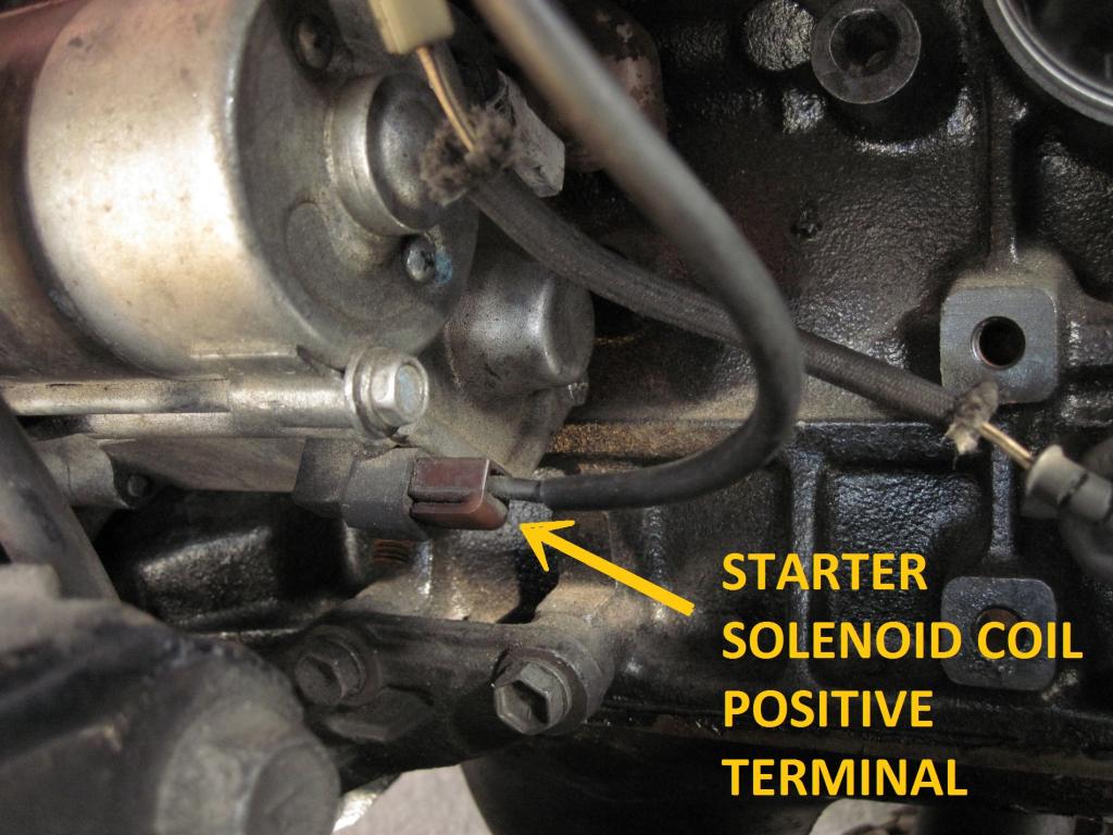

For electrical problems, you always start with your multimeter (No, I won't believe you tried to replace a fi˟˟˟˟l of wiring without a multimeter, so if you didn't have one, get one http://www.harborfreight.com/7-funct...ter-98025.html, and just don't tell us)
Pull the solenoid wire (small one) off the starter, and confirm you get 12v to ground with key-start. If not, it's the starter relay (if you have one; you didn't give a year so I don't know), clutch switch, PN switch, or the ignition switch. (Or fuses, but if you haven't checked those yet I don't think I can help.) If you get 12v on that wire, but not even a click, you've got a bad starter. WAIT! Don't pull it yet, put your ohmmeter on the starter side of the solenoid wire and confirm that it's "open" to ground (it should be, basically, zero ohms).
This is the wire that Scope103 is talking about (first gen 4Runner/2nd Gen pickup. May look different on other model-year):
While you're at it, also use this to test if starter solenoid and starter motor are fine. If this cranks the engine, focus on finding where you lost power as discussed above.
