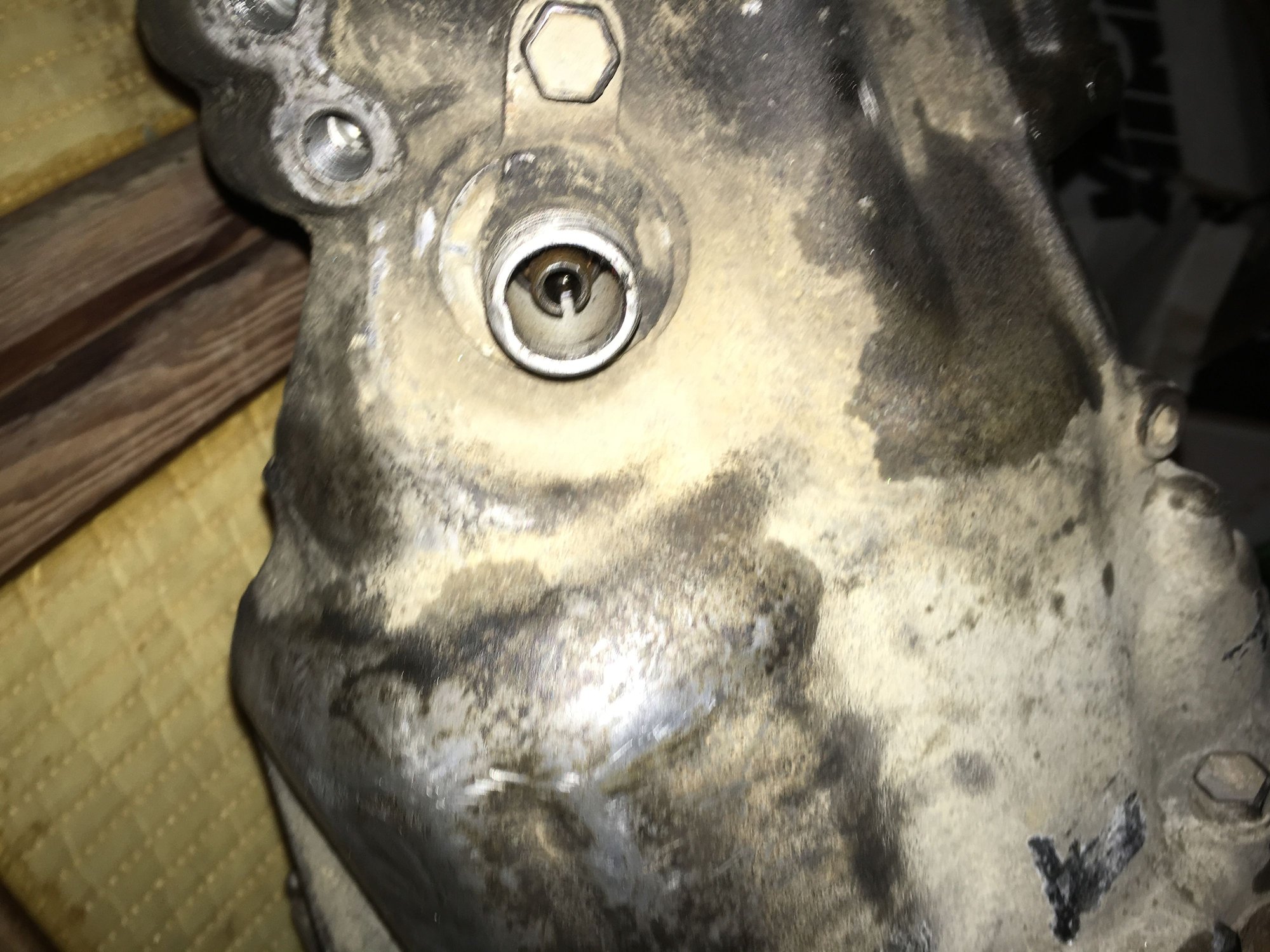

Good day to all. There are a few questions I would like answered, hoping someone can give me some insight on what I have done wrong. I am not sure if I have made the right decision. I have a 91 Toyota 22re 2 wheel drive,5 speed(manual) that I needed a transmission for. Due to financial issues I went to the junk yard and purchased a tranny from a 93 Toyota ,5 speed manual 2.4 liter, 2 wheel drive. I took my original trans with me to compare, which looked good at the time until I got home. I realized the speedometer was electrical unopposed to it being a screwed in cable.
My questions: is the trans compatible? if yes, how will the speedometer work? I have attached some photos for viewing. thanks.
Connection to the screwed in speedometer from the 91 Toyota
91 screwed in speedometer
Electrical speedometer from the 93 Toyota (Plug Out)
Electrical Speedometer from the 93 Toyota (Plug In)

Should be possible to exchange the sensors

Do you have a W55 tans? Trans model should be on drivers door.
It looks like the trans you got from the junkyard has an electric speedometer. The 1991 has a mechanical speedometer.
I have a 92 2wd 5 speed, and it's an electric speedometer.
Not sure if the 93 can be converted over to mechanical. AutoZone sells a reman trans for my 92 that costs $795. Honestly, I would save up the money, beg, borrow, or what ever to buy a reman.

Swap the whole sensor. should be a simple direct swap. you may want to get the O-ring for the sensor

I am pretty sure the transmissions themselves are the same, just the sending unit should be different, but should insert and attach to the transmission the same.
You can remove both the mechanical and electrical senders and compare to what is shown above.

Well guys, thanks for the time and assist. I made the sensor swap, was not as hard as I thought
it would be. FYI, for those who will make the swap in the future, the nut that is holding
down that little metal plate DO not lift it UP or you will brake a piece off, from
the sensor itself, LOL. After you unscrew the bolt, Slide the metal plate out ! thanks again. know I am
in the process of putting the tranny back in. thanks for the positive vibez.
