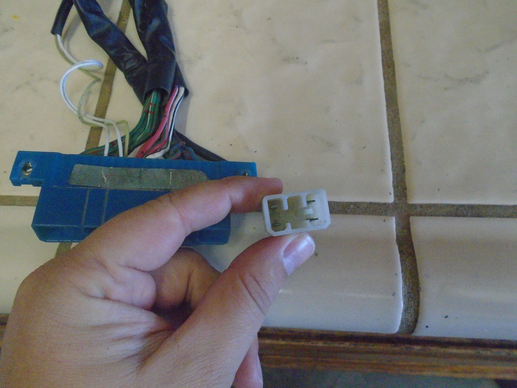

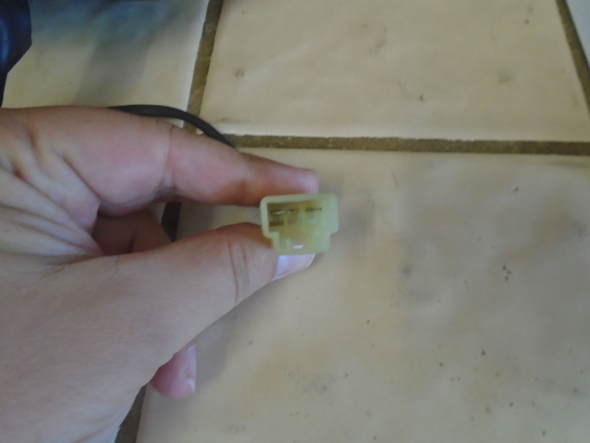

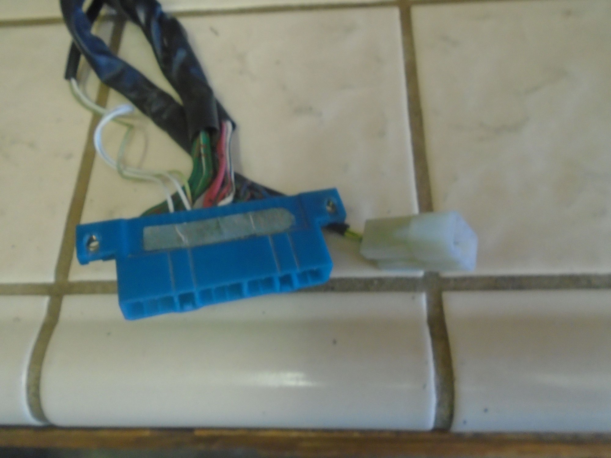

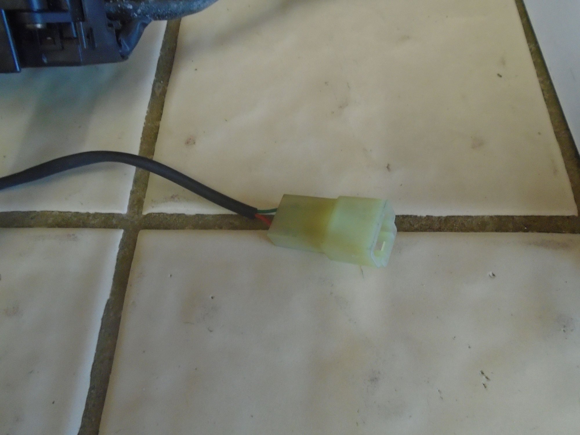

So I've got an 86 4Runner SR5 (Oct. 85 production date) that I am rebuilding. The multifunction switch was broken, so I am in the process of replacing it. It has the intermittent wipers, cruise control, tilt. I ordered one off eBay, the part number is 84310-35250. In the research I have done it claims to be for an 86-89 4Runner. The switch has the same features, intermittent wipers, cruise control. I do not know if the donor truck had tilt though, if that matters. Here's the catch. My 86 wire loom has a 6 pin connector as does the original switch, which I cannot read the part number on that. The new one, and all those I can find on the internet, only have a 3 pin connector. I am at a loss. Any help would be greatly appreciated.

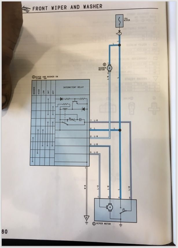

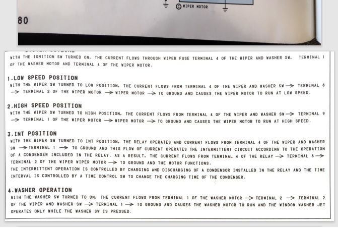

I don't know if any of this will help. Below is the page from an '89 EWD. The second page was apparently copied without including the diagrams of the connector.
Do you have a washer? 2-speeds in addition to intermittent? In the end, you'll probably have to figure out where each wire from your original connector goes, and decide if you need to keep that function.
